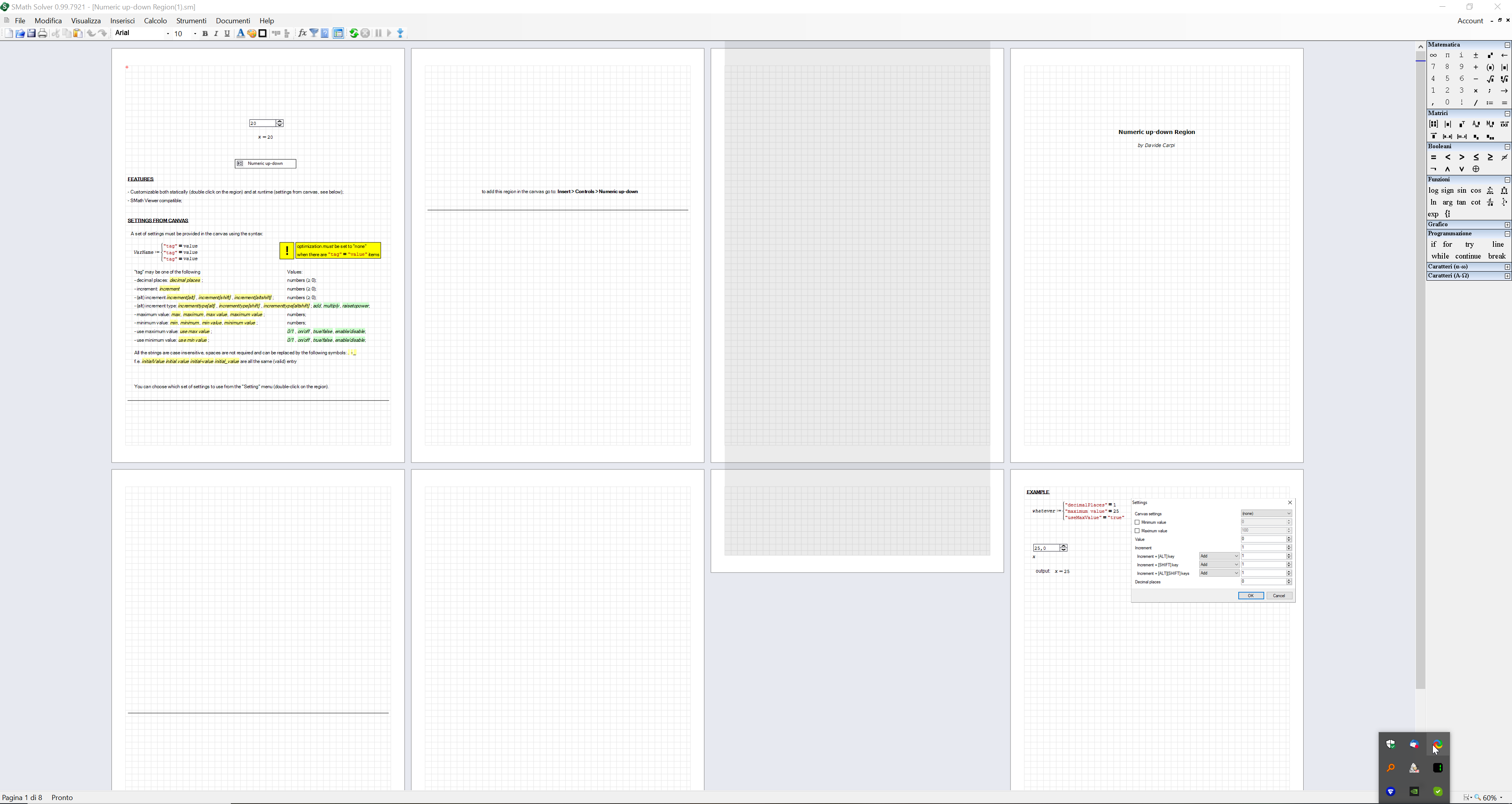

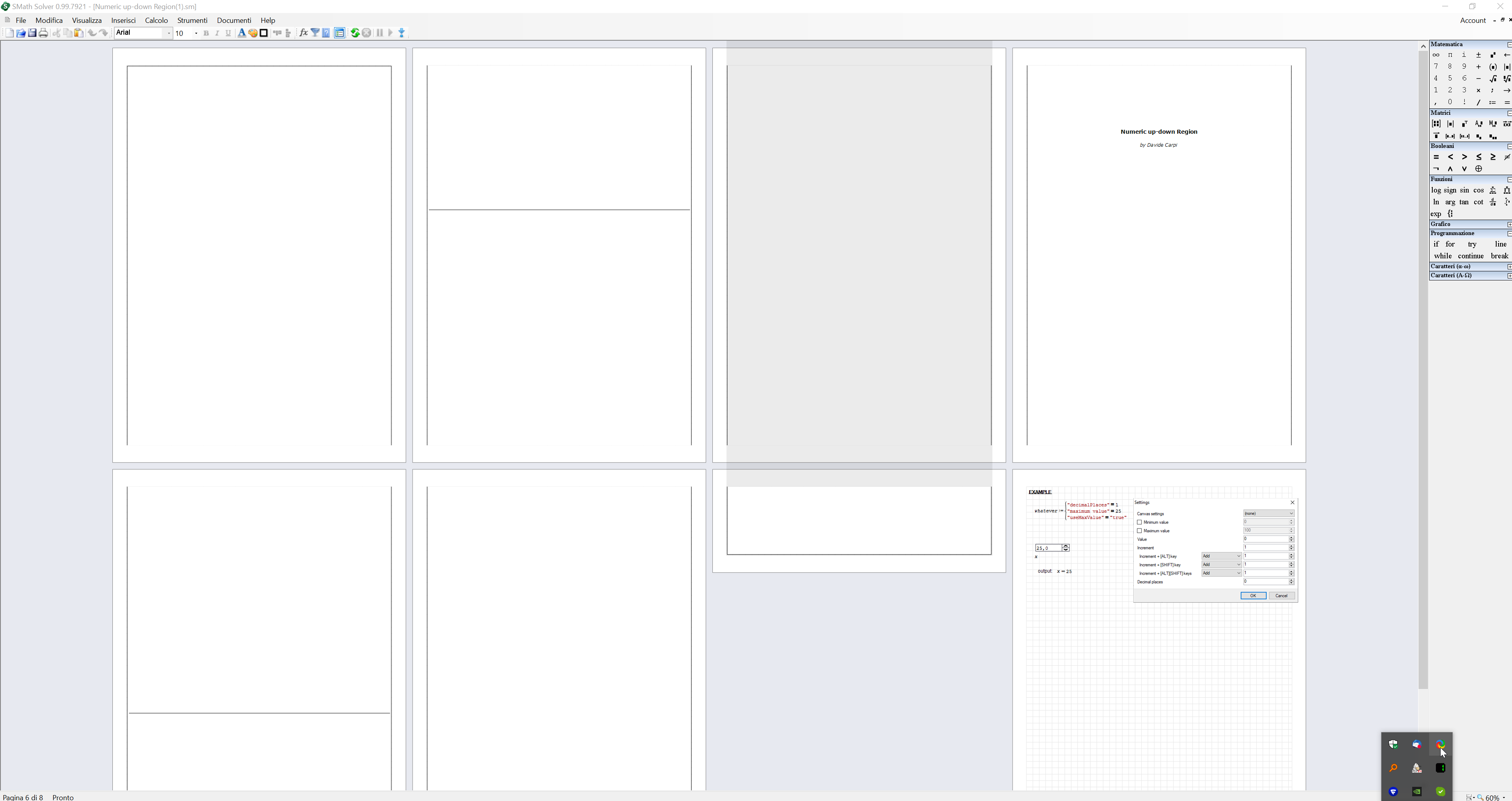

Davide, thanks for the update. I point out that by downloading the documentation file (.SM file in the post # 1) I have verified a strange behavior: First the open file does not contain well-paged; but mainly by clicking at any canvas point, large white regions that cover everything appear.

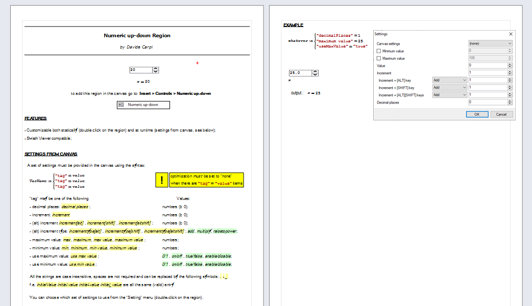

I'm not able to reproduce this behavior. Can you check if it happens to you even in a clean portable build on the same machine?
That's the expected layout:

I tried a clean portable version (obviously uploading the file I was asked to install plugins: Numeric Up-Down and Writer) by detecting the same problem. I attach the first image is how the file is presented at the opening and the second image is what happens by clicking on the canvas.

#25 Posted: 12/30/2021 12:21:36 PM
554 likes in 1333 posts.
