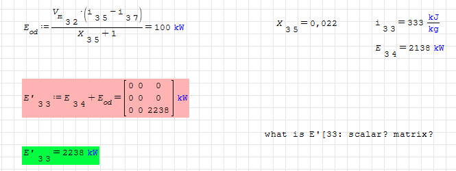

Now check this (it is a part of a bigger calculation). If I use equal sign after assignment I get a matrix. If I try to get result again in next line, it magically renders to scalar.2018-03-28 10_23_45-SMath Studio - [sprawdzenie.sm_].png
Please: next time, attach the *.sm document
