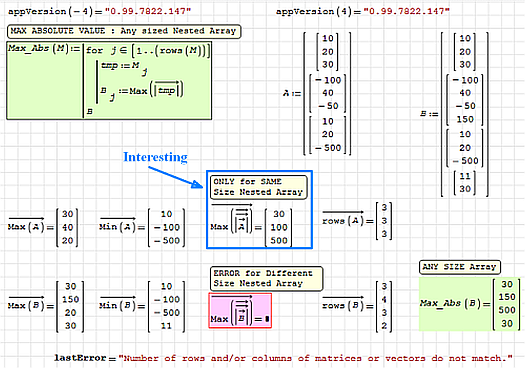

#32 Posted: 8/22/2021 10:28:04 AM
NDTM Amarasekera
NDTM Amarasekera
130 likes in 352 posts.
Vectorize function on Nested Array revisited.
Cheers!
