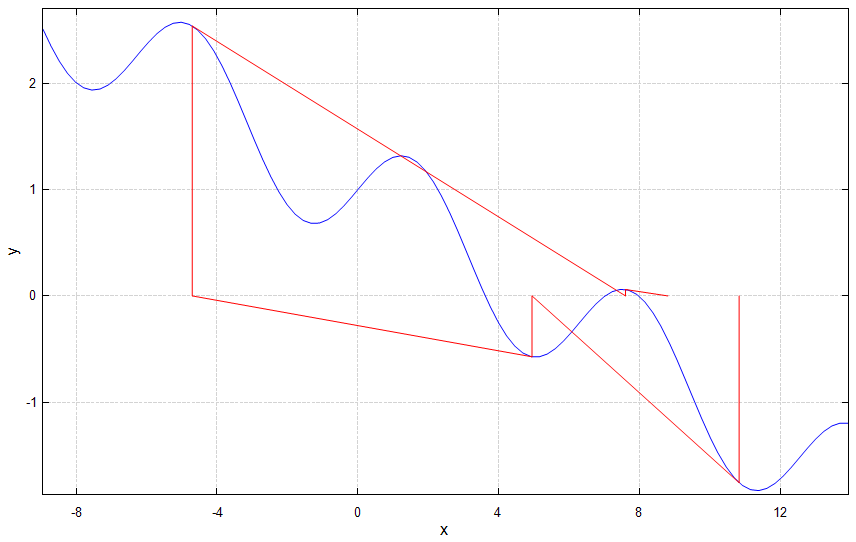

I tried to make a simple sheet that would show the path the Newton-Raphson approximation takes to get to a solution based on an initial guess.
The problem I'm having is that it's very slow with anything more than 2/3 iterations.
I'm not sure why it is slow. I can simulate the loop in steps and none of the calcs are slow outside of the loop.
Any ideas as to why this is so slow for i>2. i=3 is still okay, but is gets eternal after that.
In this particular case, the solution converges at the 7th iteration for two decimal places of accuracy.
This is a snip of 4 iterations, which takes well over 2 minutes...

#2 Posted: 2/22/2023 4:31:04 PM
I changed optimization of for loop to Numeric. It runs in less than a second on my machine.

#3 Posted: 2/22/2023 4:44:57 PM
I knew it was going to be something simple like this. Thanks!
