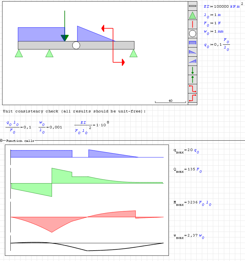

BeamFEA updated:
Unit support was non-trivial. I failed to make the solver unit-proof because matrix inversion with units is not robust in SMath (probably due to poor pivot scaling in the algorithm).
Also, you easily can create programs which will crash SMath immediately after opening them (if auto-recalculate is on). I added this to SS-1227.
- unit support. You can specify units as factors for the modeler units. The preprocessor eliminates the units such that the solver input is unit-free. In the output the appropriate units are applied and can be modified as usual for display. Note that you can define separate units for length ('l.0)and displacement ('w.0).
- separate diagrams for distributed load, transverse force, bending moment and displacement
- input color scheme changed:
- concentrated moment load and rotational constraint in red
- concentrated forces and vertical supports in green

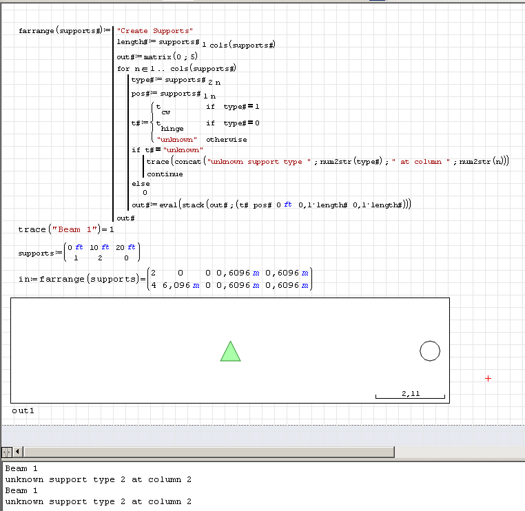

OK, I am going to try and finally get to work on this.
I will take the approach "either you generate a fake modeller output and feed that into the preprocessor"
Maybe Oxel has done some work on this?
I'm not sure which is best though. I could have the user input span lengths or input the location of the supports/hinges. My instinct says that maybe entering nodes is best then you can also define if the node is a hinge. So you have:
All inputs would have units
Support/hinge Matrix:
Row 1: location of support
Row 2: 1/0 (support / hinge)
Uniform Load matrix (uniform over all spans):
Row 1: Load
Partial load matrix:
Row 1: Start magnitude
Row 2: Start location
Row 3: End magnitude
Row 4: End location
Point Load matrix:
Row 1: Load magnitude
Row 2: Location
Sooo....
We would then create a matrix for the supports. We would call on template 2, set the X, set the y=0 say, not sure what to use to define there width/height.
I will start here see how it goes.
Also I hope to keep in mind that everything should be function oriented and repeatable on the same page.
Modeller input.sm (29.67 KiB) downloaded 1433 time(s).

#68 Posted: 1/25/2015 7:51:10 AM
RFreund, sorry for not being responsive lately. Quite busy at the moment.
I think for the supports you succeeded to implement the translation function from your favorite input format to modeler output. I just made some modifications:
- better readibility by introduction of temporary variables and by replacing nested ifs by cases()
- better robustness by creating valid modeler input even in case of unknown support type. In that case, a detailed error message is written to the output window via trace(). This is essential, as the input selection in the modeler gets lost whenever the input renders invalid. This is annoying, because you have to re-select the pre-defined layout in the modeler again.

#70 Posted: 1/25/2015 11:57:59 AM
Martin,
Again thank you for the response. Attached is an updated version, probably with poor scripting again by myself (side question, is "scripting" the correct term to use here?).
So a few questions/comments:
Thanks again! I think once I have a figured this out I will have an efficient beam calculator and I can start posting more analysis / design examples/snippets.
Modeller input.sm (82.27 KiB) downloaded 1443 time(s).
- Could you elaborate on cases()? When I type in cases its description is "Define piecewise functions"
- Also (maybe this is cases) but how did you create the system using if and otherwise?
- I'm not sure the best/simplest way to handle the scaling of the beam and loads. If I understand correctly, the beam height from the modeler is given to the preproccesor and used for EI. Likewise the height of the loads are used to determine magnitude in the preprocessor. Therefore it would seem that I need to relate the scaling of the beam to the E and I input and the loads to the load input. However I think that maybe it would be more 'robust' if the scaling was separate from the loading input. That way you can change the scaling to proportion things as you'd like. Or mabye all items should be in proportion to the length of the beam. Maybe this is wrong though. In any case, I think that direct input into the preprocessor would be too challenging for me or creating unnecessary work and my main objective is to have a functioning script and maybe we can modify later. I'm looking for input on what you think is the best approach.
- Another issue is Varying loads that are trapezoidal in shape. Really I need to send the w.p# input to a script which checks for this condition and creates a new matrix with a partial uniform load a triangular load over the same length of beam. In the attached a put a small section of script showing my intent.
#71 Posted: 1/28/2015 11:43:46 AM
cases(): You find them under cases() in the function index of the interactive handbook.
trapezoidal distributed loads: You indeed have to stack them from uniform and triangular loads in the modeller, because trapezoidal templates would have a fixed ratio of left to right value regardless of scaling.
In the element matrix, however, you can specify the corner values directly.
Units and scaling: there is a cloud version with units: http://smath.info/cloud/file/NESDC.
