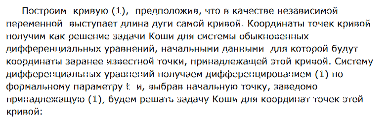

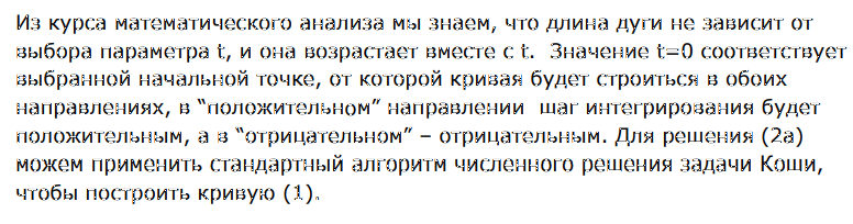

A lot. For instance, from the paper that you give as reference ( https://vk.com/doc242471809_437831729 ) can read:
"From the course of mathematical analysis, we know that the length of the arc does not depend on the choice of the parameter t, and it increases with t. The value t = 0 corresponds to the selected starting point, from which the curve will be constructed in both directions, in the “positive” direction the integration step will be positive, and in the “negative” direction - negative. To solve (2a), we can apply the standard algorithm for the numerical solution of the Cauchy problem to construct the curve (1)."
"We construct the curve (1), assuming that the length of the arc of the curve itself is the independent variable. The coordinates of the points of the curve will be obtained as a solution to the Cauchy problem for a system of ordinary differential equations, the initial data for which will be the coordinates of the previously known point belonging to this curve"
But the final parametrization isn't along the arc length.

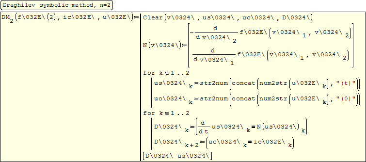

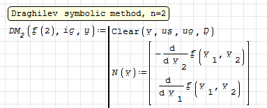

Hi Jean. What you see is the unicode code for some ornaments. I use them because I don't like the use of x#, y# ... etc for each variable in the definition and body of the SMath procedures.
Maybe you don't have the unicode version of Courier New font.

Special characters mode is available since Version 0.99.6617, hence can't be rendered correctly in Jean's 0.98.6179 (no matter what fonts he has)
Please note that decorations aren't really needed since 0.98.6325 when Clear() was made built-in and that is enough to isolate line() procedures from external variables (useful in Jean's 0.98.6179, though)
What is the meaning of your messages? Using the arc length as an independent variable is a well-known technique and is not directly related to the Draghilev method, but can be used in the implementation of the method. For example, I widely use this technique. This is achieved by simple normalization of the variable of integration by the magnitude (dx^2 + dy^2 + dz^2)^0.5, in the case of 3d.
Yes, I hope you understand that the curve itself is always unambiguous?

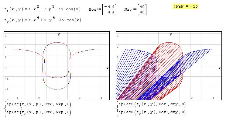

If you find some volunteers to code Tom G. Mathcad contour ... please feel free.
Hi Jean. Problem for code in SMath this procedure it's about that NaN is unavaible in SMath. Here you can see what happens without NaN, and a workaround of that:
https://en.smath.info/forum/yaf_postst12539_Implicit-Plot.aspx
iplotq.sm (40.7 KiB) downloaded 1703 time(s).
The iplot routine is from uni works in mathdcad.

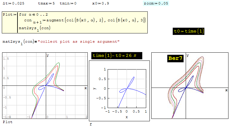

#32 Posted: 10/28/2018 12:00:46 PM
Fridel Selitsky
Fridel Selitsky
520 likes in 451 posts.
Dragilev method for equations with a parameter.Equations borrowed from Jean Giraud .
JeanContour1.sm (11.52 KiB) downloaded 1549 time(s).
Jean.sm (11.18 KiB) downloaded 1525 time(s).

Jean, try without a maple.
Jeansolve.sm (11.06 KiB) downloaded 1553 time(s).
