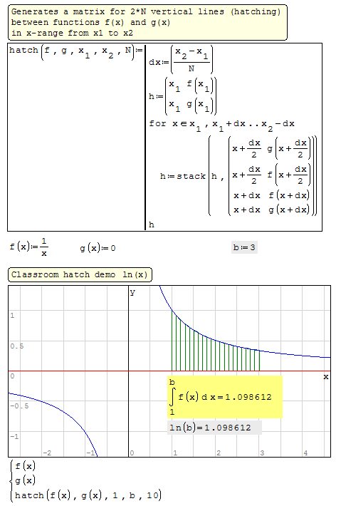

WroteFridel, thanks for revisiting the snippet and the performance issue. Quite odd for me: The fastest way seems to be direct element adressing without pre-allocation and avoiding stack(). See attachment. The speed-up is significant.

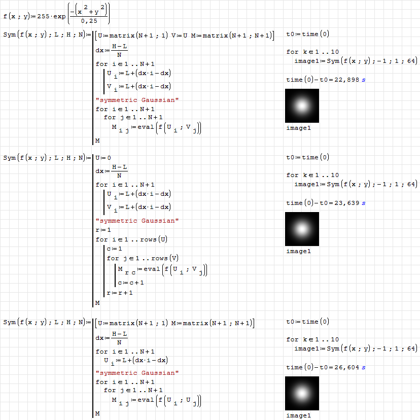

Preallocating is when you say "let's V:=matrix(20,1)", and then just work defining V[1, V[2 ... etc. If you found that don't need all 20 numbers, just can use submatrix. But if you don't preallocate V, but use V[1 ... V[20, and program work fast, who is preallocating must to be SMath, and that's isn't very efficient for the general cases. Or have some pointer very good for handle that matrices, and I don't know C at that level.

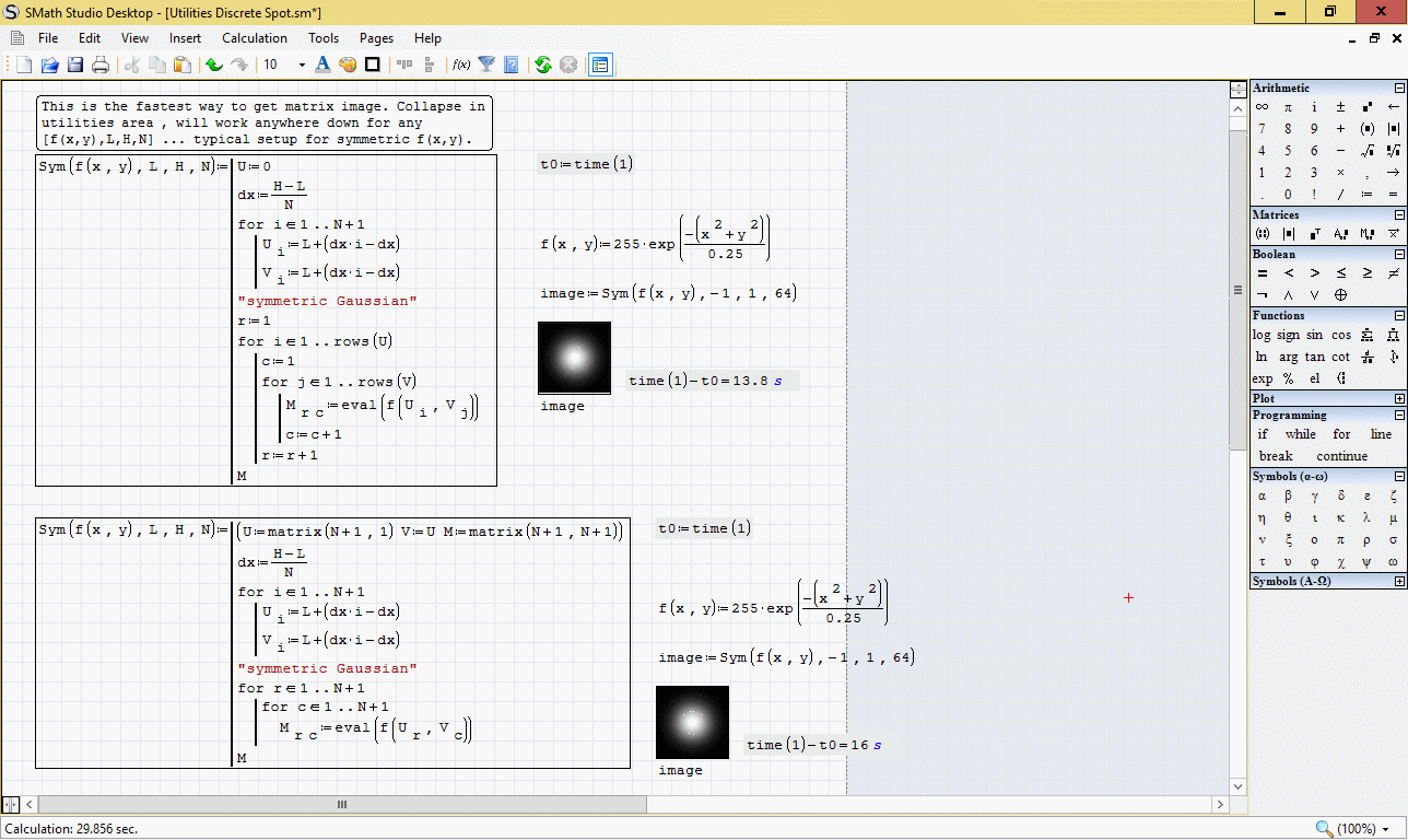

In your example, "Utilities discretes", it is suposed that defining U:=matrix(N,1), and same for V, must to be faster than having U:=0 and then use U[i
WroteI understand that stack or augment are bad strategies, but without pre-allocation is better than with pre-allocation? If it is, why is without pre that good. Seems to be to much faster than I can explain or understand.
Much faster than what? Please provide an example to discuss.
WrotePreallocating is when you say "let's V:=matrix(20,1)", and then just work defining V[1, V[2 ... etc. If you found that don't need all 20 numbers, just can use submatrix. But if you don't preallocate V, but use V[1 ... V[20, and program work fast, who is preallocating must to be SMath, and that's isn't very efficient for the general cases. Or have some pointer very good for handle that matrices, and I don't know C at that level.
It's a common practice in libraries to pre-allocate some space for any container. Without this, it would be very inefficient to manage memory. Further, re-allocation strategies on the low level are quite efficient, because they either use % of current size to grow (typical are 2x or golden ratio), or linked lists that don't need reallocation at all. SMath doesn't need to do that itself, because it's .NET that does that for it. And it's VERY efficient for general cases.
WroteIt is supossed that second algorithm must to be faster than your's, but it isn't.
Well, your slower second time could be explained like this:
pre-allocation in SMath is high-level operation, and it simply adds one additional high-level (slow) operation.
And it could explain something, if not one little thing ... actually it doesn't matter.
SMath calculation time is very volatile, and it's hard to measure time reliably, even doing multiple comparisons/calculations. E.g., processor temperature, that raises towards second calculation, may cause it to slow down to prevent overheating (contemporary systems do that). Some memory leaks in SMath may cause slow-down of all subsequent calculations (and when the sheet is done calculation, .NET garbage collection may clean it up, so recalculation shows the same picture).
Here is a screenshot that shows that your "second" calculation, put first, outperforms original.
Though the "algo style" existed in Smath before I joined the team, it
was not elegant and in some ways not visible. As you can see, in the
attached, there is one less "augment" in ... pts(data,spec) compared to
plotG(vx,vy,char,size,color) decreasing the computing time by a factor
of 12 on my testing over 1000 points. You may have better suggestion(s).
For sure welcome in the experiment room .

WroteWroteI understand that stack or augment are bad strategies, but without pre-allocation is better than with pre-allocation? If it is, why is without pre that good. Seems to be to much faster than I can explain or understand.
Than I can explain or understand. Sorry, have not examples of that.
Thanks for the explanation, now I understand why mkraska says "The fastest way seems to be direct element adressing without pre-allocation". Because preallocating is with a high level instruction, and then is slow. Even I have the doubt about why NET pre-allocat V:=0 as matrix when user define that as scalar. I suposse that default SMath types are complexes, not matrices.
So, for the best practices book in SMath, which is best? Never preallocat? Or there are some size when NET take more time than SMath because the NET pre-pre-allocation (the jus't in case one) isn't enough big?
Wrotenow I understand why mkraska says "The fastest way seems to be direct element adressing without pre-allocation". Because preallocating is with a high level instruction, and then is slow.
No, I tried to show this. One single allocation instruction's duration is null, zero, nothing. You will be unable to notice it in any measurements in SMath. Martin was not correct. I will say it once more: one method (assigning 0 and then addressing elements) is not faster than the other.
QuoteEven I have the doubt about why NET pre-allocat V:=0 as matrix when user define that as scalar. I suposse that default SMath types are complexes, not matrices.
No, it "allocates" a scalar (very fast) once, and then re-allocates a vector with a sensible pre-allocated size (very fast) once.
QuoteSo, for the best practices book in SMath, which is best? Never preallocat? Or there are some size when NET take more time than SMath because the NET pre-pre-allocation (the jus't in case one) isn't enough big?
I prefer always preallocating when I know the size. It won't hurt. Its "overhead" of high-level instruction is the same as of the assigning 0 and then re-allocating. In a function, it will not make any difference until the system preallocation size is exceeded, and then, when the function will handle big matrices, it will give you (insignificant, if any) performance gain.

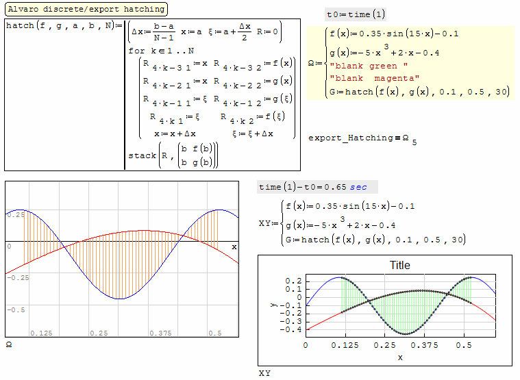

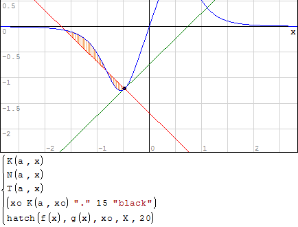

Martin program is very crafty ! Instead of hatching by creating each vertical bar manually, it
creates the same as manual but adjustabe in 'N' and between the two plots in question. His argument
of the plot is f,g,x.1,x.2,N in hatch(f,g,x.1,x.2,N), just like asking to plot 'x' in ln(x).
So, 'f,g,x.1,x.2,N' is purely "scalar" in the sense of a vanishing iterator once done the plotted
value on the Smath QuickPlot.
As you remember from Mathsoft Collaboratory, so much I loved Mathcad 2D ...
... so much Smath QuickPlot produces more convenient graphs. OK, some missing features but monkeys
survive with bananas only, is it ? On the hatching demo [attached next post], if you plot points
the hatching looks blank. Not at all, they are all there but not joining because the points confuse
on each plot trace.
The first module is fully compatible with Maxima X_Y plot, i.e:
traces color, symbols, hatching color ... great for publishing.
Martin scalar hatching is slightly faster, not to account in project.
Your module [Alvaro] is great for extracting a particular bar but
couldn't add to the plot ???
Tanks, Jean
2DPlots Hatch Demo [Martin, Alvaro].sm (23 KiB) downloaded 138 time(s).
