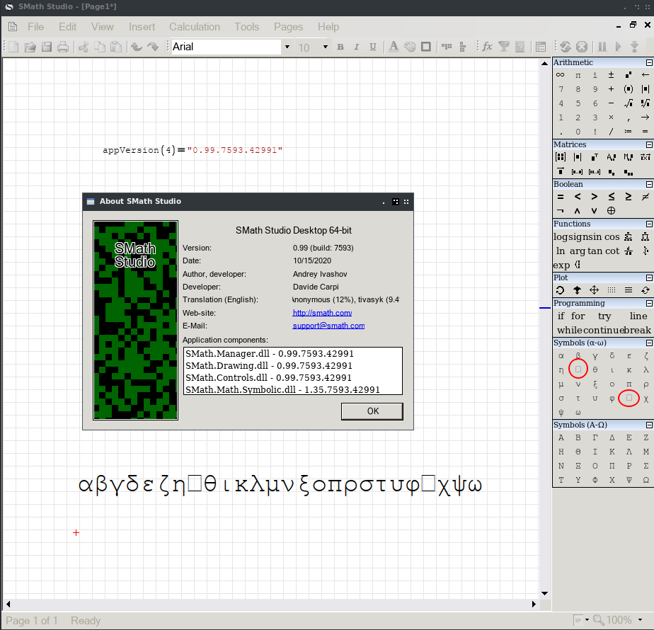

#24 Posted: 10/15/2020 10:36:29 AM
2273 likes in 3737 posts.
Please try this build: http://smath.com/file/nbUXn - created for testing only. It has SVG based icons on Boolean toolbox. Windows & Linux. They are not that sharp as before, but at least we can check if they are visible and readable. These icons uses system color for text now (instead of black in PNG images).
If it will be OK all the buttons can be recreated using this technic.

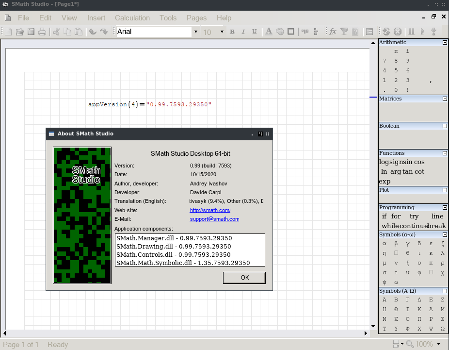

#25 Posted: 10/15/2020 10:58:59 AM
554 likes in 1333 posts.
This is how it is on my setup.
Same as previous builds.
#26 Posted: 10/15/2020 11:15:34 AM
Hmm, then this is not because of incorrect image...

#29 Posted: 10/15/2020 6:37:10 PM
One more attempt: http://smath.com/file/mV3da
Please try and let us know if toolbox buttons are visible now.
All is working excepts those two characters.
Congrats, a long mystery is solved.
By the way, maybe that's just my linux setup but;
If I use only the keyboard for "Evaluate symbolically (Ctrl+.)" it is not working too.
Button is fine for calculation, just keyboard combination doesn't work.
Andrey Ivashov 10/15/2020 6:40:00 PM, Davide Carpi 10/15/2020 7:45:00 PM
#30 Posted: 10/15/2020 7:47:19 PM
Great! Thank you!
This is because of Font missing some Greek symbols. Please try to write these chars in TextRegion and test different Fonts for this Region. I'm sure you will find some Fonts which will allow to render all Greek chars correctly.
overlord 10/15/2020 10:15:00 PM

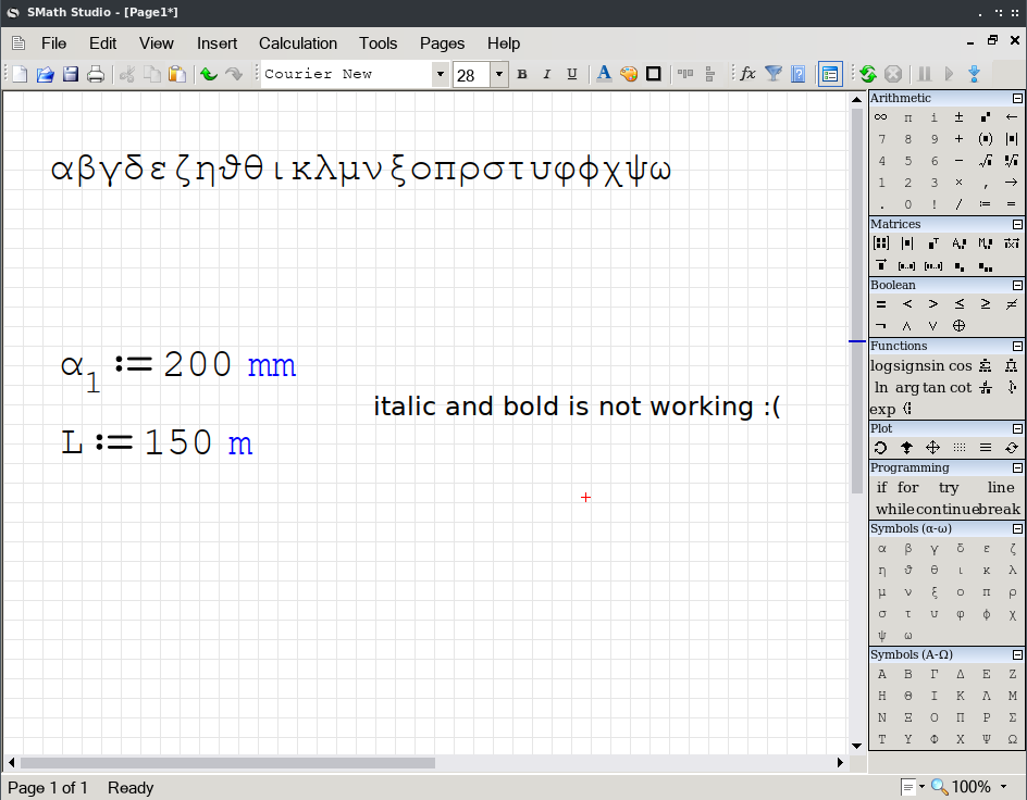

#31 Posted: 10/15/2020 10:08:47 PM
Great! Thank you!
Yeap, you were right. I have copied courier font from windows font folder to linux now everything is in order.
Apparently free courier fonts are missing some characters. (which had derived from a previous archlinux setup)
There is no font or sidebar issue now as you can see.
Well, because I have grumpy and complainer personality I have seen another problem.
Bold and italic (and combined) is not working also.
Expressions should be italic and greek characters above is bold actually.
You can see this issue at picture below.
Regards.
