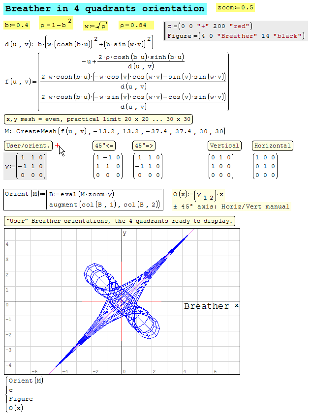

Hello Carlos,
"3/4 view" : like setting TV screen 3/4 or other style.
You could scale the vertical vector, it would end being
hugly. The x, y ranges in the CreateMesh have these limits
under the hood. These limits are what make the Breather
so pleasant like the Eiffel shape.
Attached the 4 fixed orientations.
Rotate Breather [4 Orientations].sm (17.15 KiB) downloaded 1414 time(s).

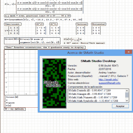

#24 Posted: 8/4/2016 1:19:20 PM
CBG
CBG
78 likes in 312 posts.
Hello Jean.
Excellent !!!
But the file does not work for me, it indicates that M is not defined.
Besides, I can not update the Maple plugin .
On the other hand , Is it possible to see a 3/4 view from the Z axis?, I think it will better.
Thank you.
Carlos

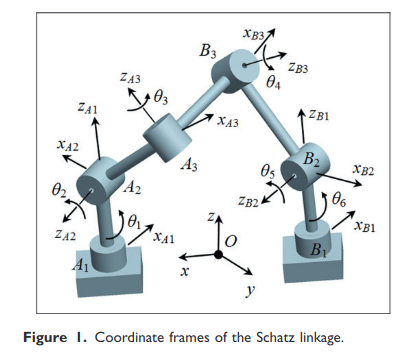

The Schatz mechanism
https://espace.curtin.edu.au/bitstream/20.500.11937/7649/2/203604_136865_Schatz_JMES_author_draft_02.pdf
The Schatz mechanism provides a perfect dynamic balance
оf both centripetal and centrifugal forces as patented in 1971
as the only widely-used overconstrained linkages in industry,
mainly used as spatial mixing-machines.
Shatz 2cikla.sm (128.56 KiB) downloaded 1637 time(s).

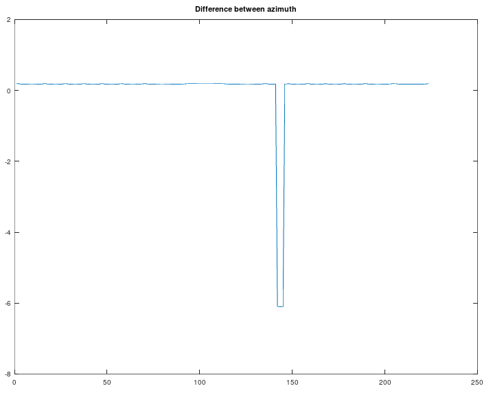

#28 Posted: 3/9/2022 5:10:10 PM
grelkin2
grelkin2
14 likes in 66 posts.
Puma manipulator
The working body of the manipulator moves along a given trajectory.
To solve the problem, 5 equations with six unknowns were used.
-Two link length equations
-Equations of the condition that the links are in the same plane
-Two space curve equations
In my option this system have
  • Rigid link between 2 points
  • 2 equations about belonging 2 points to the same sphere
  • x2*y1-y2*x1
  • some sin curve
    Don't quite understand about x2*y1-y2*x1. Some spherical meaning? The difference between azimuth angles is not perfect equal. Replace with atan(y1/x1)-atan(y2/x2) to make perfect equal.

#30 Posted: 3/10/2022 4:07:49 PM
grelkin2
grelkin2
Hmm, atan is expensive function, may be switching to spherical coordinate reduces number of steps
initial vector
1.5355 0.8065 0.9959 1.9127 0.5761 0.0989
precision 1e-3
sphere(1,0,0,0)
sphere(2,0,0,0)
line(1,2)
atan(x[1]/x[0])-atan(x[4]/x[3])
.5*sin(8*x[3]+9*x[4])-x[5]

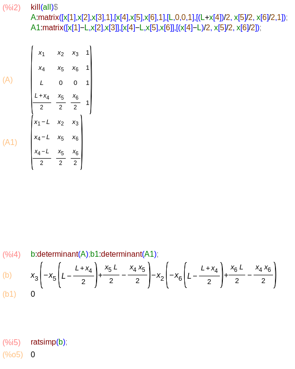

#31 Posted: 3/15/2022 1:33:50 AM
grelkin2
grelkin2
It has equation four points are coplanar
Maxima gives me this equation is exactly is zero with any coordinate

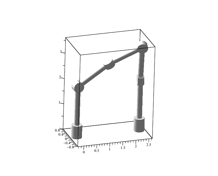

The Schatz mechanism. Modernized animation.
Schatz Linkage.sm (143.74 KiB) downloaded 1670 time(s).

In the Schatz mechanism, the length of the middle link does not change, and the axes
of the middle link are constantly perpendicular to each other.
In this case, one vertical rack (input link) rotates uniformly.
This is for those who are interested.
And Draghilev's method does not directly work in this case.

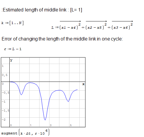

The error of changing the length of the middle link is ε = 10^{-7}
You can also check the perpendicularity of the hinges
Proverka.sm (47.9 KiB) downloaded 1600 time(s).

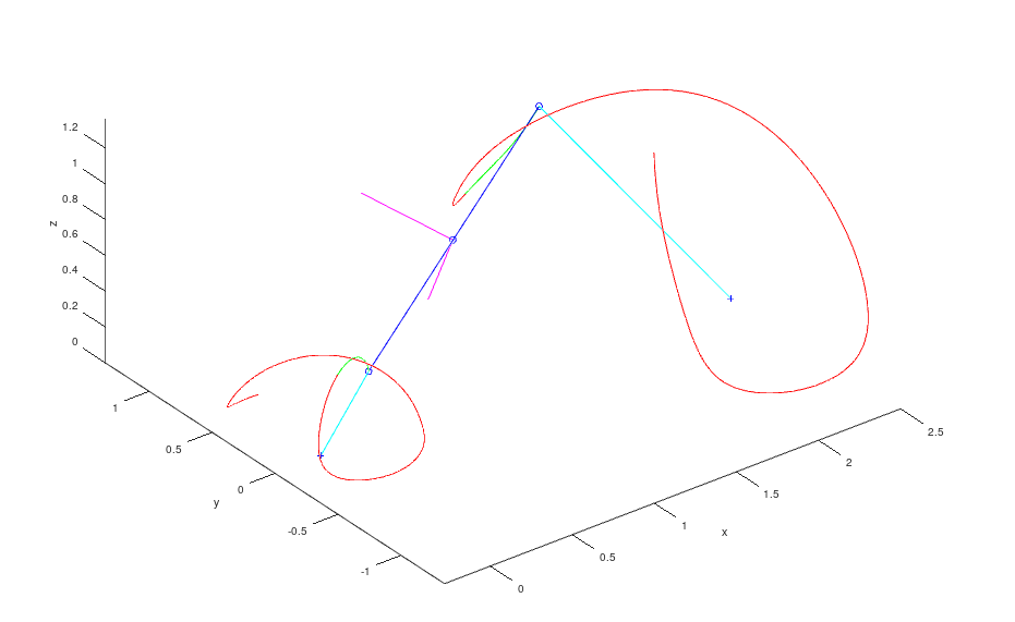

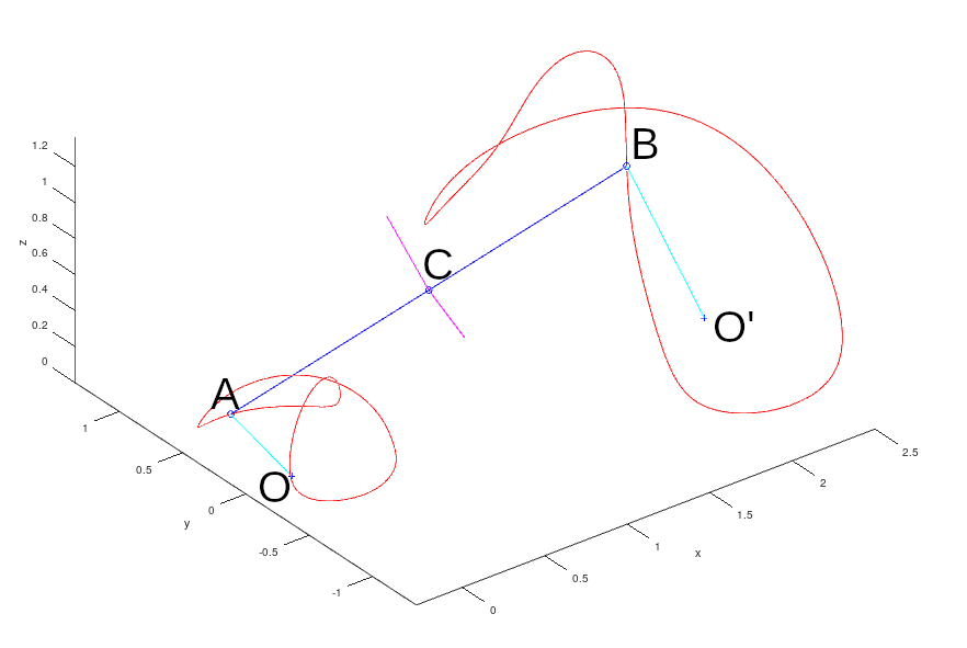

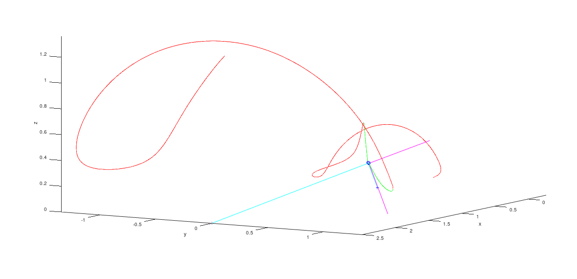

#35 Posted: 4/11/2022 8:33:46 PM
grelkin2
grelkin2

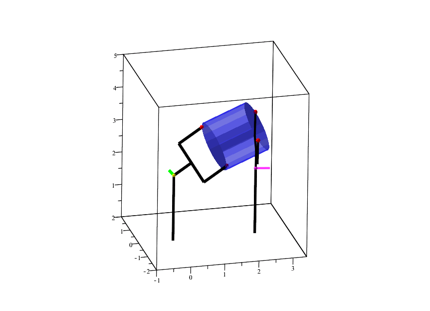

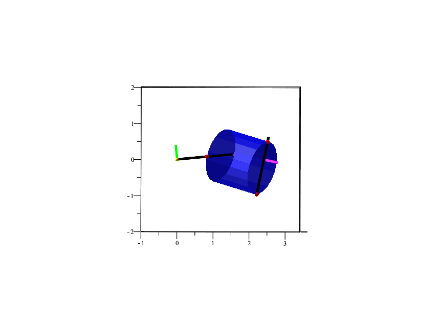

To @Ber7, @алексей_алексей
Not really understand Schatz system
Please correct me if I'm wrong
AO=const, BO'=const, AB=const
С extra point, AC=CB
Still two equation, one as I understand Z1*Z2=const?
and the last one is
Normals to planes ABO and ABO' must be perpendicular?
Magenta lines are normal vectors to ABO and ABO'
Pause and check perpendicularity
Rotate the view to get best observation
Make animation in mov format for the best quality, If not working, message me
Animation schatz.mov (285.1 KiB) downloaded 348 time(s).
#36 Posted: 4/13/2022 11:37:22 AM
Fridel Selitsky
Fridel Selitsky
520 likes in 451 posts.
Please, read the article at the link post # 27.The length of each link is equal to one, and the distance between the vertical axes is equal to the root of 3.Equation x3*x6 = 1/2 derived from Equation (6) of this paper.
"Normals to planes ABO and ABO' must be perpendicular?" Yes.
#37 Posted: 4/13/2022 2:39:49 PM
grelkin2
grelkin2
sinθ_2*sinθ_5=const
θ_2, θ_5 rotating angles around the ZA2, ZB2 rotating axis, difficult equation
You cann't use any intial values for coordinates because ABO and ABO' must be perpendicular, if you fixed all coordinates but one, you've got Quadratic equation. If you have no real roots change others coordinates and try again. Also you can change equation to be cos(α)=const, α≠90, α is angle between normals
