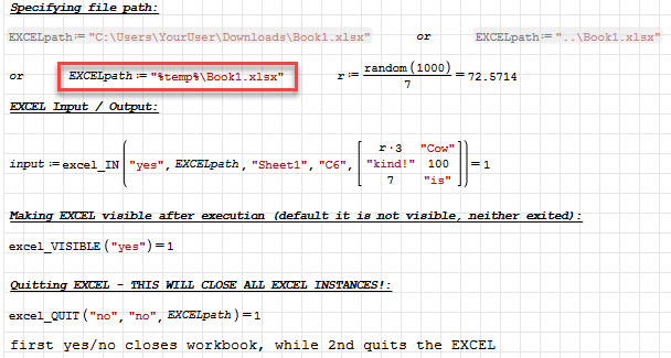

#113 Posted: 7/3/2022 5:04:57 AM
Plugin updated. ...
- added support for environment variables;
Hi Viacheslav. An example about what does that mean? Thanks.
#114 Posted: 7/3/2022 6:10:06 AM
1,555 likes in 1,867 posts.
You can use operating system environment variables in the file path.
4 users liked this post
NDTM Amarasekera 7/3/2022 8:00:00 AM, churichuro 7/3/2022 12:59:00 PM, Alvaro 7/3/2022 3:51:00 PM, oscar mauricio 7/7/2022 11:37:00 AM

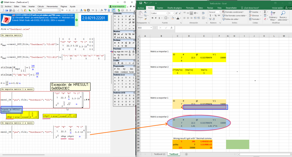

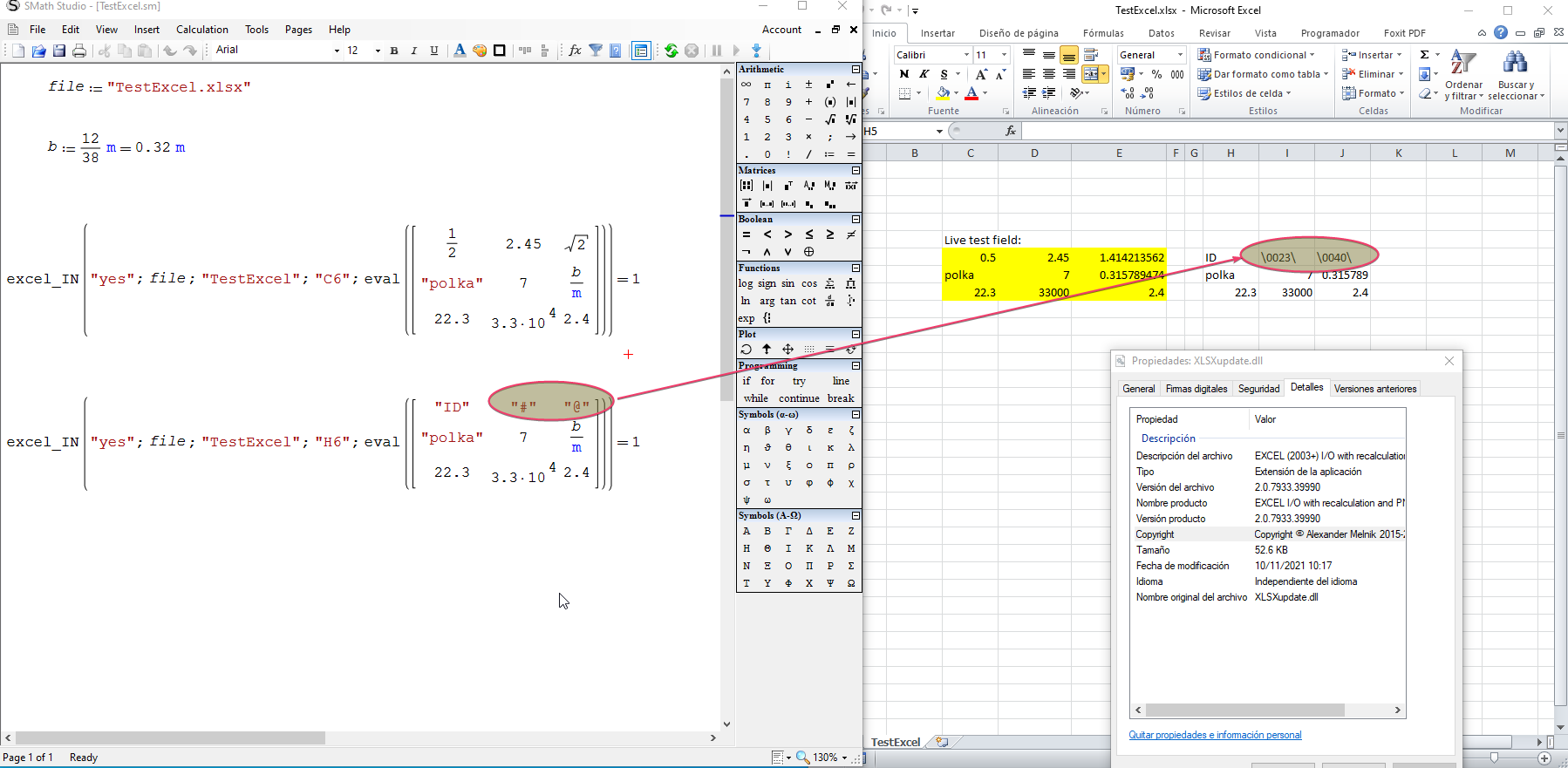

Hello thanks for the plugin, I found a problem in the excel_In() command. I present it in the image, I hope it can be resolved in future versions.
#116 Posted: 7/8/2022 4:45:19 AM
SMath Studio compatibility
Plugin updated. Please try.
Changes:
- ToCell(): Globals.Excel.DecimalSeparator replaced by the CultureInfo.GetCultureInfo( "en-EN" ).NumberFormat.NumberDecimalSeparator;
- ToCell(): Double.Parse() fixed;
- part of the book "Excel 2002 VBA Programmer's Reference" added (Chapter 22. International Issues).
Click to enlarge
oscar mauricio 7/8/2022 4:00:00 PM

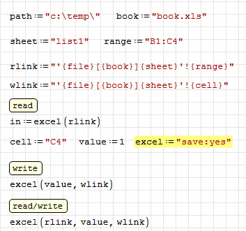

Changes:
- excel operand and excel() function added;
- readCell() and writeCell() moved from the ExcelIOCom plugin;
- examples added;
- refactored.
sergio 7/11/2022 5:47:00 AM
