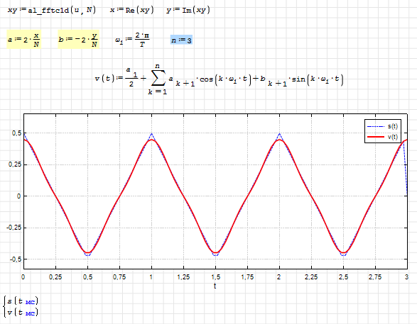

With numeric optimization (for all functions) it works much faster.
Fourier series coefficients.sm (17.54 KiB) downloaded 1681 time(s).
Fourier series coefficients.pdf (138.41 KiB) downloaded 979 time(s).

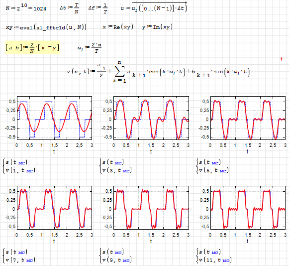

Example 2.
Fourier series coefficients.sm (28.46 KiB) downloaded 1813 time(s).
Fourier series coefficients.pdf (170.26 KiB) downloaded 1132 time(s).

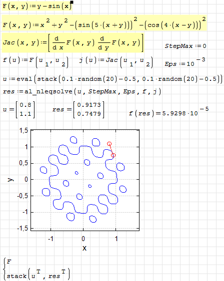

Parameterization of implicit functions with al_nleqsolve
Parametrisation.sm (29.88 KiB) downloaded 1720 time(s).

Hi Ber. Nice technique, easy to implement. You can also make that as a function, and monocolor too.
Parametrisation.sm (25.37 KiB) downloaded 1656 time(s).
Another option could be use y0 as vector, and solve for each element in y0, obtaining res, res1, ..., resn
