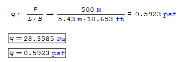

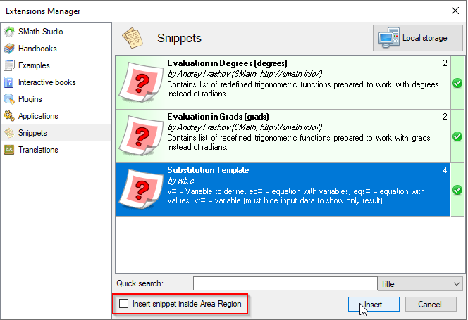

Then you go to the snippet manager and select the snippet you added (Substitution Template) and insert it (uncheck inset inside area).

The final result looks like this:
The variable is assigned the value the same way as a standard calculation (because it is just a regular calculation inside a text region), you can change the display unit if you want.

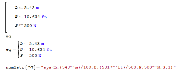

So the essential feature for displaying substituted values in definitions is the access to the verbatim definition of that values without simplification before storage.
The Mathcad block seems to be able to pave the way. In the screenshot below, the variable eq contains all information which is required to display the expression for c as expression and with substituted values.
Plus, it shows a proof of concept, how to build a string for display in a table region (a formatted label also works).
All the definitions are actually active and can be used as usual, without restrictions and without typing anything twice.

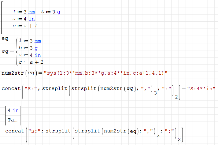

IMHO these could be a possible implementation:
- Create a function, which takes the name of the variable whose calculation is to be documented for manual check, possibly in string form if the verbatime name is spoiled by preprocessing.
- The function borrows the sheet scanning capability from Mathcad region (this is a possible show stopper, I am not sure if this works)
- This function creates a string for display in a formatted label, containing everything wb.c was asking for
- Put the function call in the formatted label and switch off border and input data.
That should be pretty close to your dreams.

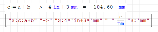

Here is a version with a table region.

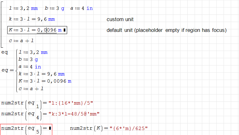

This seems to only work with nice round numbers. num2str(1) seems to force the output in exact form.
The information on the original units and the original precision is still there and can be extracted from the string. It is not as easy as in the integer case but it is possible to implement in a display function.
There is another problem: num2str() fails to convert expressions like K:3*l=0.0096*'m@# (a definition with integrated display and default unit).
Note that this doesn't happen if the display unit has been specified explicitly.
Possible mitigation:
- fix num2str() to handle this case.
- if a variable to be substituted isn't found in the list of successfully converted expressions from eq, then use it's value from the context. This doesn't harm as using the default unit will be just right.
I don't say that writing the display function is trivial. Yet the fundamental problem of loosing input information upon storage in the context isn't a show stopper any more.
