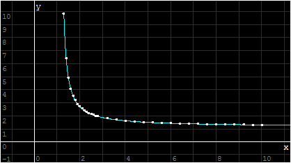

This is an approach, maybe Jean or Alvaro, can Doctor it
Hello Carlos, maybe like this ... solve(2) to let the solver breath freely.
PileRedux_Factor_CBG [1].sm (24,35 КиБ) скачан 1162 раз(а).

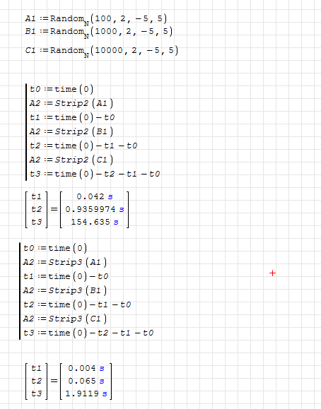

Hi Jean,
See attached. I've modified your strip2() algorithm [See Strip3()]. On my PC it performs same calculations ~10x faster. Might help with large data sets.
PileRedux_Factor_CBG [1]_alyles.sm (31,33 КиБ) скачан 1214 раз(а).
#24 Опубликовано: 28.03.2019 12:37:37
Arie
Arie
Here's some proof of that.

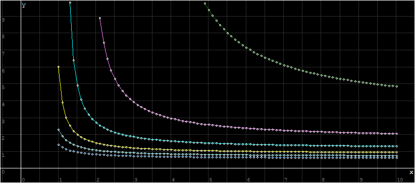

Thanks alyles ... Good job !
#26 Опубликовано: 28.03.2019 13:37:05
CBG
CBG
Hola Carlos. This is another approach.
PileRedux_Factor_CBG.sm (115,19 КиБ) скачан 1358 раз(а).
PileRedux_Factor_CBG.pdf (376,79 КиБ) скачан 738 раз(а).
Hola Alvaro.
Gracias
I make the next comment. In none of the 3 graphs that you show,
the scale of the "Y" axis, reaches the value 10, so I think,
it would be necessary to expand the scale to verify that the curves are correct
Carlos

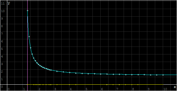

#28 Опубликовано: 28.03.2019 15:17:41
Carlos, the limits are the limits of the solver.
I refactored a bit to understand myself easier,
played a bit the lower limits [A5, A6] ... bingo !
That reminds me how long it toke Mathcad 11 to solve
the Solar Cell project ... let say ~ 1 month.
Page4 Carlos.sm (29,2 КиБ) скачан 1527 раз(а).

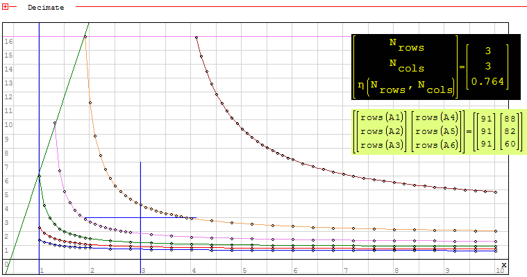

#29 Опубликовано: 28.03.2019 22:29:22
Hello Jean
Thank you so much. Very pretty. Best Regards. Carlos
Hola Carlos,
Few more things to improve presentation ...
Decimate part of the A1, A2,A3 . Confirm project is valid
particularly withe 'z' target in A solvers.
Project PileRedux_Factor_CBG [1].sm (30,8 КиБ) скачан 1210 раз(а).

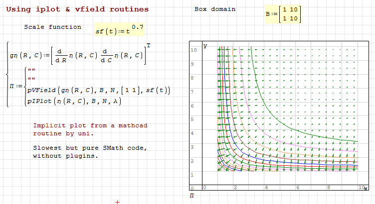

#30 Опубликовано: 28.03.2019 22:42:38
... I make the next comment. In none of the 3 graphs that you show,
Hola Carlos. Maxima shows 10 for both axis, IPlotSolve, by construction, only can take two vectors (x or y and lambda) but not 3 (x and y and lambda).
For pIPlot and pVField, just change the Box in 'B'. I take columns only one to five.
#31 Опубликовано: 29.03.2019 09:45:43
Hola Carlos,
... decimated plots are lot more presentable.
At this point, for a specific target solution
easy to get a Thiele analytical formulation.
In the mean time, I will test some decay model.
Project PileRedux_Factor_CBG [1].sm (46,98 КиБ) скачан 1160 раз(а).
