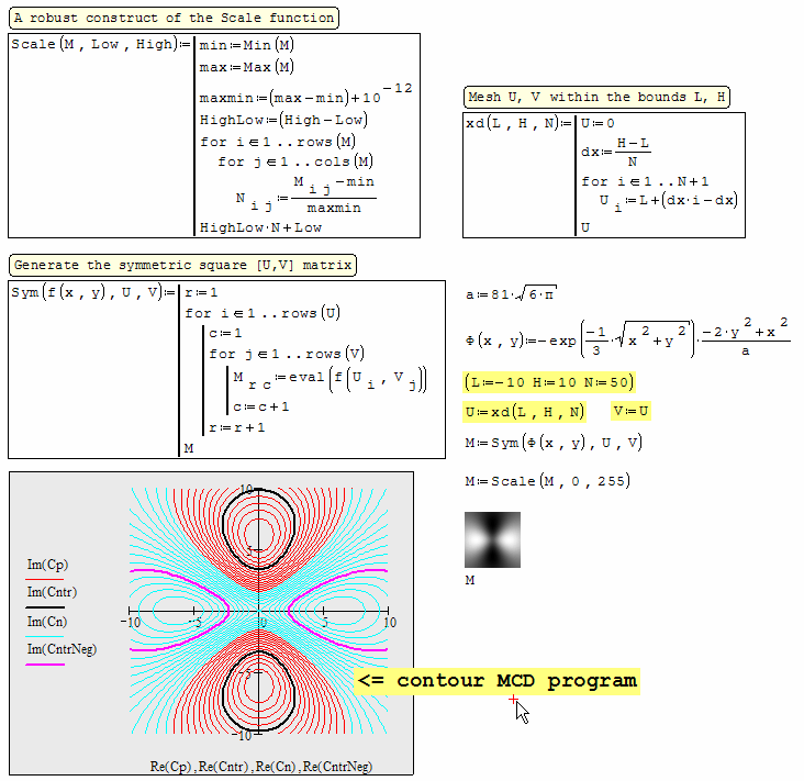

Jean, on a side note, what is your comment on a quality of DISLIN generated plots?
There are already so many 3D plots, many are freeware.
Scilab, DISLIN ... Surfer 8 [dedicated Contour plot, not freeware].
I see DISLIN via a menu driven and equation editor, Mathcad style.
The first thing is a the same CreateMesh than Mathcad. Let say the
two planes X, Y and the level Z plane and in parametric style.
That sets the complete 3 D system, meshed at will and supporting
the entire user rotation from command line as well as cylindrical/
spherical plots and export the corresponding matrices. Contour is
something else of much different nature. Contour plots ends being
an XY plot. I have a Mathcad contour program [done by Collab].
Just scared to attempt Coding in Smath. Some of you gurus, I can
make an image of the program for your bed time reading.
There remains the question about freeware: how far can somebody
reverse Engineer and redistribute ?
Cheers Alex, Jean
#42 Опубликовано: 04.04.2016 18:54:22
... that's what I meant about a comprehensive "DISLIN start".
Contour is for exporting specific contour data. The feed is a
matrix, either well populated or splined and you get what you
want. Collapse the function, plug the matrix from source or
from function ... ready for the contour(s), just few clicks.
I lost patience trying to imitate Mathcad "on error".
So, attempting the program is not tempting.
The program images included in the *.sm work sheet.
Contour Electron.sm (239,09 КиБ) скачан 1513 раз(а).

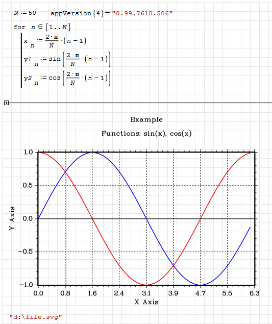

Currently I'm working to improve SMath Studio start up time. Have good results (made it up to 4x faster), but I've found that DISLIN plug-in requires from 4 to 14 seconds (different environment) to response on call to GetTermsHandled. Which is the most significant part of SMath Studio start up time.
Is it possible to improve the logic here?
#44 Опубликовано: 27.10.2020 09:02:58
1 534 сообщений из 1 850 понравились пользователям.
I'll see what I can do or will change the way I use it.
Andrey Ivashov 27.10.2020 09:22:00, Davide Carpi 27.10.2020 11:02:00, sergio 27.10.2020 11:51:00
#45 Опубликовано: 04.11.2020 16:23:17
Updated. Refactored. Startup time has been reduced.
Andrey Ivashov 05.11.2020 06:34:00
#46 Опубликовано: 04.11.2020 23:36:55

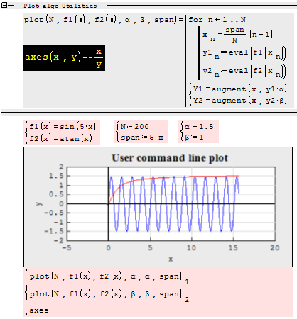

... native SS 6179 ... sorry but I have no interest *.svg
Stand alone user command line is more my cup of tea.
