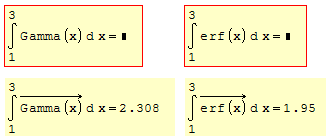

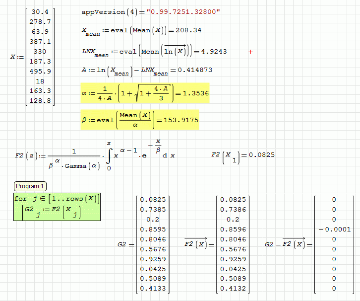

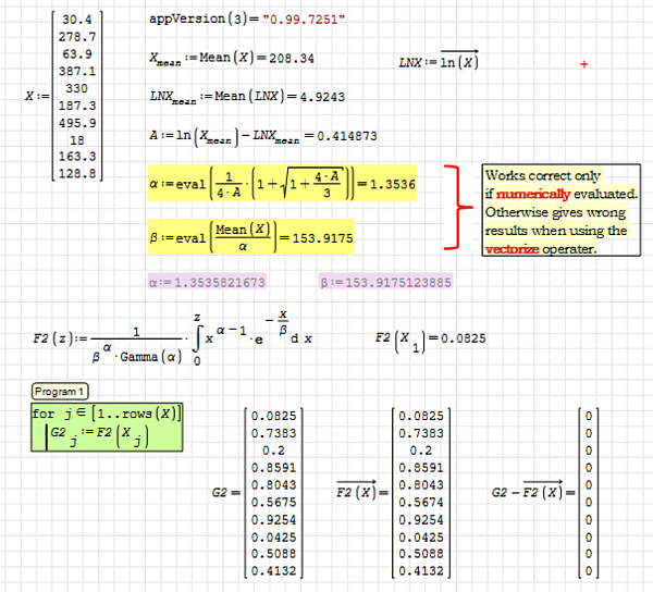

#25 Опубликовано: 14.11.2019 18:01:53
NDTM Amarasekera
NDTM Amarasekera
Observed same problems even after a second Clean re-installation of 7251.
Consequently, I noticed that the Vectorize operator works correctly
when eval() function is used to evaluate alpha and beta of the Gamma function.
Otherwise, it gives incompatible results.
Has anybody experienced this issue?

#26 Опубликовано: 14.11.2019 19:23:02
Any comments?
New_Test_Gamma.sm (11,13 КиБ) скачан 1339 раз(а).
Hi Nugegodage. I slightly modify your file, putting eval only where Mean appear. What I see rigth now, with your new file using eval, not before, is that there are not bug, and the "bad results" are because Mean can't be vectorized (or better say, isn't a good idea vectorize them), like any other function that take vectors or matrices as arguments.

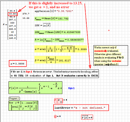

#28 Опубликовано: 12.05.2020 12:55:50
NDTM Amarasekera
NDTM Amarasekera
Gamma CDF function error revisited.
Following issues observed while trying to calculate SPI for a different set of data.
1. Gamma CDF function fails if 0 <'alpha' < 1
2. Even Razonar's method fails in such a situation.
3. According to the literature on calculation of SPI, the Gamma function is valid
for all 'alpha' values > 0.
4. No such issues in Excel or Mathcad.
5. Attached example is only to demonstrate the issue.
For the attention of authorities.
Gamma_CDF_Error_with_Alpha less than 1_.sm (13,59 КиБ) скачан 1422 раз(а).

#29 Опубликовано: 12.05.2020 16:02:58
Your integration is ill posed ... "x_undefined"

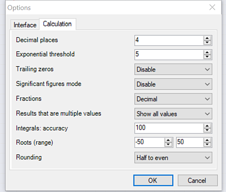

SMath native Gamma(x) 4 decimals and INT acc 50 have no impact.
Try your own alpha/beta.
Page1 NDTMA.sm (13,24 КиБ) скачан 1556 раз(а).

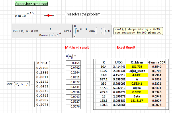

#30 Опубликовано: 13.05.2020 00:40:30
NDTM Amarasekera
NDTM Amarasekera
Thank you Jean. Your suggestion to introduce ε=10^{-15} as lower limit of integration
solved my problem. But still the error persists if lower limit is zero.
A beginner may be confused and/or discouraged in a similar situation.
Gamma_CDF_Error_with_Alpha less than 1_SOLVED.sm (106,47 КиБ) скачан 1360 раз(а).

#31 Опубликовано: 14.05.2020 08:18:01
I see the issue... when alpha < 1 and t = 0 smath has 1/(0^(1-alpha)) and the numerical integrator fails. I'm not sure about how ccould be fixed.
Looking for improvements in the Gamma function...
Lanczos.sm (69,27 КиБ) скачан 1323 раз(а).

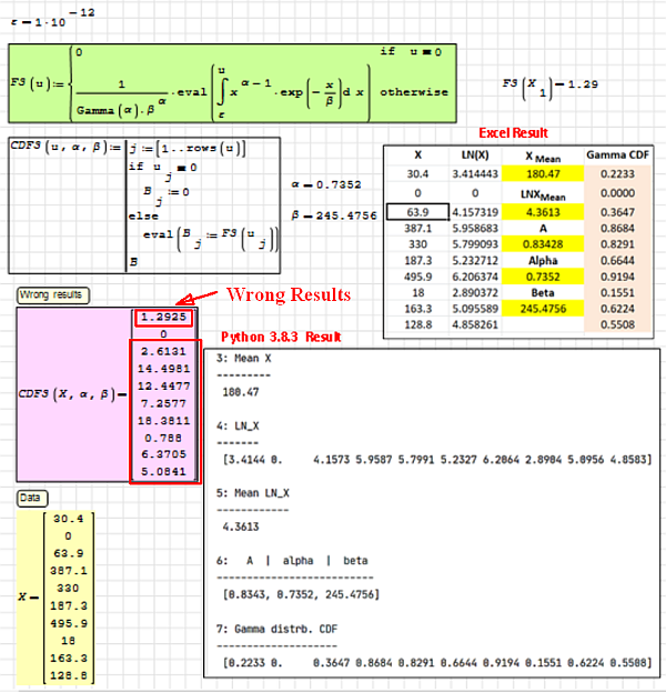

#34 Опубликовано: 19.05.2020 05:49:32
NDTM Amarasekera
NDTM Amarasekera
A few more issues please.
Gamma_CDF_Error_Wrong_Results.sm (334,88 КиБ) скачан 1446 раз(а).
#35 Опубликовано: 19.05.2020 08:26:46
Freak 7251 does not open !
You just have two values: α:=0.7352, β:=245.7456
That's enough to simulate/evaluate CDF.

#36 Опубликовано: 20.05.2020 01:41:58
NDTM Amarasekera
NDTM Amarasekera
Sorry. PDF attached. Thank you Jean!
Gamma_CDF_Error_Wrong_Results.pdf (953,82 КиБ) скачан 819 раз(а).
#37 Опубликовано: 20.05.2020 10:46:24
Ordinary Simpson is inadequate [too steep PDF, too long X's]
Romberg/Simpson algo style is just perfect.
All done in gray attached.
Cheers mon Ami from so far away !
CDF Gamma.sm (277,8 КиБ) скачан 1357 раз(а).
