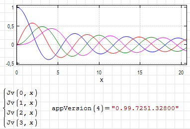

Please help!
Program version 0.99
Installed the Userefi extension
Bessel functions don't work.
Copied mathlib.dll in \Application Data\Match\extensions\plugins\91a20d24-c30b-4774-9b1b-4d502a80420f\1.0.7165.40625\userefi
The Bessel functions don't work anyway.
How do I make them work?
#26 Опубликовано: 12.05.2020 07:52:17
All functions from the mathlib.dll library you can find in Cephes Math Library.
Все функции из библиотеки mathlib.dll содержатся в дополнении Cephes Math Library.
#27 Опубликовано: 12.05.2020 08:20:20
These 4 [J,Y]
Bessel JY.sm (85 КиБ) скачан 71 раз(а).
#28 Опубликовано: 12.05.2020 08:40:51
sashkin_kot
sashkin_kot
Thanks, it seems to work!
