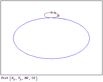

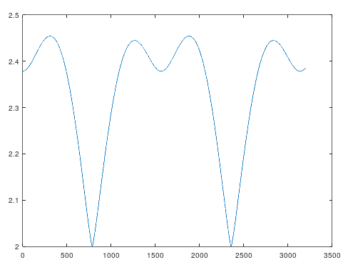

Arc length is about 7.335. I changed N is your sm file to 121 points for smooth curves. rkfixed is a reliable basic method, the other methods are needed for optimization or experimentation or have specific uses.
Below is a plot of the translational velocity of the oval at which the velocity at the tangent point is zero.

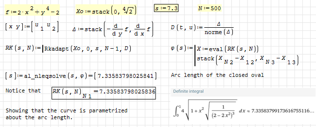

Hi grelkin2
Arc length is about 7.335. ...
This is how Dragilev's method can be used to calculate the arc length of a closed curve numerically. My improvement on Dragilev's method consists in dividing the system of differential equations by its norm to obtain the parameterization of the curves along their arc length. I have not seen this observation anywhere else.
Arc length of a planar closed curve - Dragilev Method.sm (29,44 КиБ) скачан 1895 раз(а).
Yes, like my approach with 31 points, except that your zero is more zero than mine, which is only an approximation, but a pretty good one, because to detect it you have to zoom in on the graph. There is no numerical method that can withstand a sufficiently large zoom on its graph. It looks like you use more than 3000 points, something SMath couldn't handle in this case. One question: what's the interpration of the values of the x-axis?

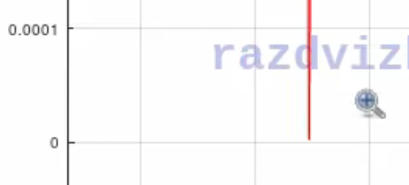

You could have sufficiently large zoom in octave.
olv2.mov (161,87 КиБ) скачан 447 раз(а).
Value of the x-axis is the number of points at a given accuracy. I changed the accuracy and, accordingly, the number and combined everything in one animation.
olv3.mov (365,73 КиБ) скачан 435 раз(а).
#167 Опубликовано: 01.11.2024 05:16:04
If 1000x is enough zoom for you, and make this point zero, it is ok for me too.

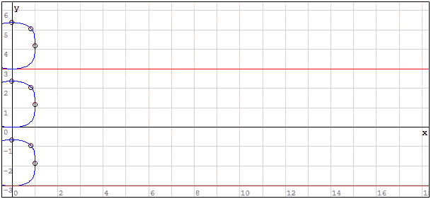

With and without sliding.
Rolling Curve - Dragilev Method.sm (41,71 КиБ) скачан 1920 раз(а).
Rolling Curve - Dragilev Method.pdf (262,09 КиБ) скачан 1050 раз(а).

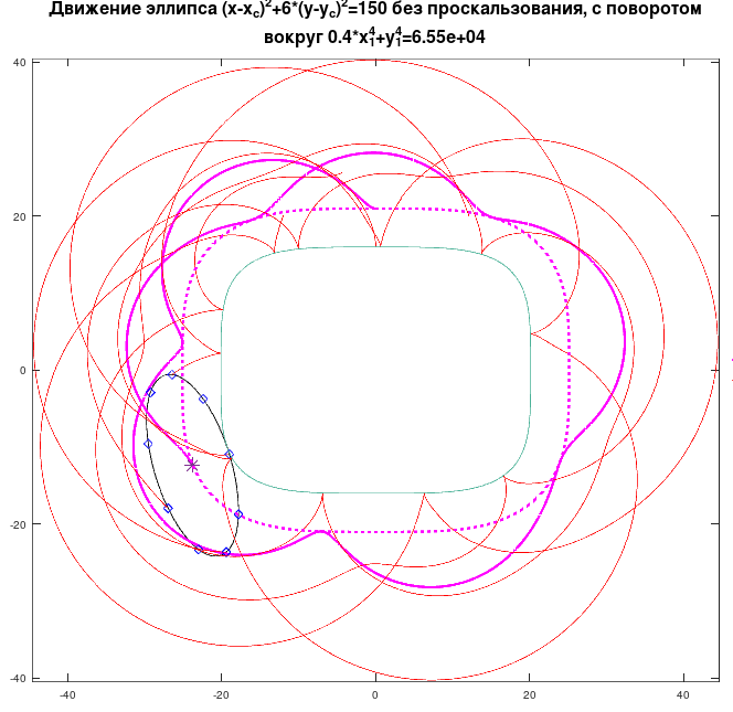

[RUS]Движение эллипса без проскальзывания с поворотом относительно заданной кривой. Улучшенная способ расчета движения точек эллипса только при помощи системы ду. Видно, что центр эллипса движется по некой кривой, зависимой от эллипса и эквидистанты к неподвижной кривой. При окружности центр бугет двигаться по эквидистанте.[/RUS]
[ENG]Motion of an ellipse without slip with rotation with respect to a given curve. An improved way of calculating the motion of the points of an ellipse using the de system only. It can be seen that the center of the ellipse moves along some curve dependent on the ellipse and equidistant to the fixed curve. For a circle, the center of the ellipse moves along the equidistance.[/ENG]
elnkr.mov (811,8 КиБ) скачан 452 раз(а).
