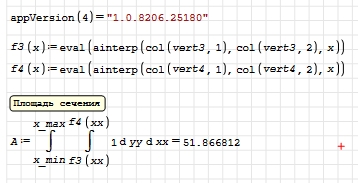

Hi avp. Try using eval() for ainterp().
Thanks, this is how the integrals are calculated, but the function containing the integral inside still returns an error. Accordingly, the final result of the calculations still failed to be obtained.

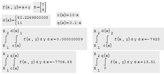

I dont know. I wanted to know here why the calculation of integrals, which used to work well before, broke down after adding the ability to use the dimensions of units in integrals.
WroteI don't know. I wanted to know here why the calculation of integrals, which used to work well before, broke down after adding the ability to use the dimensions of units in integrals.

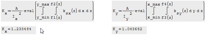

The result is not correct. The result should be Kx = 1.233, Ky = 1.044
WroteThe result is not correct. The result should be Kx = 1.233, Ky = 1.044
... those values are same in my document.
You didn't report working/crap ?
Hi, Alvaro. The result is not correct. The result should be Kx = 1.233, Ky = 1.044
Hi avp. I hope the problems with double integrals can be solved, because the calculation of double integrals that SMath had was quite powerful. The only way to calculate Kx, Ky would be to discretize and integrate over the cubic splines curve.
