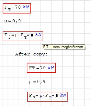

I've found an issue with the lower indexes (usually after modifying indexes):
Sometimes I couldn't copy part of formula to other formula, because I got an error message.
I use Hungarian international settings (decimal point is the comma), and the last SMath Studio version (v0.98 build 6484).
Here is a sample:
Issue with Lower Index.sm (4,94 КиБ) скачан 1731 раз(а).

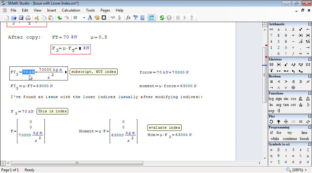

make sure you don't confuse index/subscript
Issue with Lower Index.sm (10,91 КиБ) скачан 1759 раз(а).

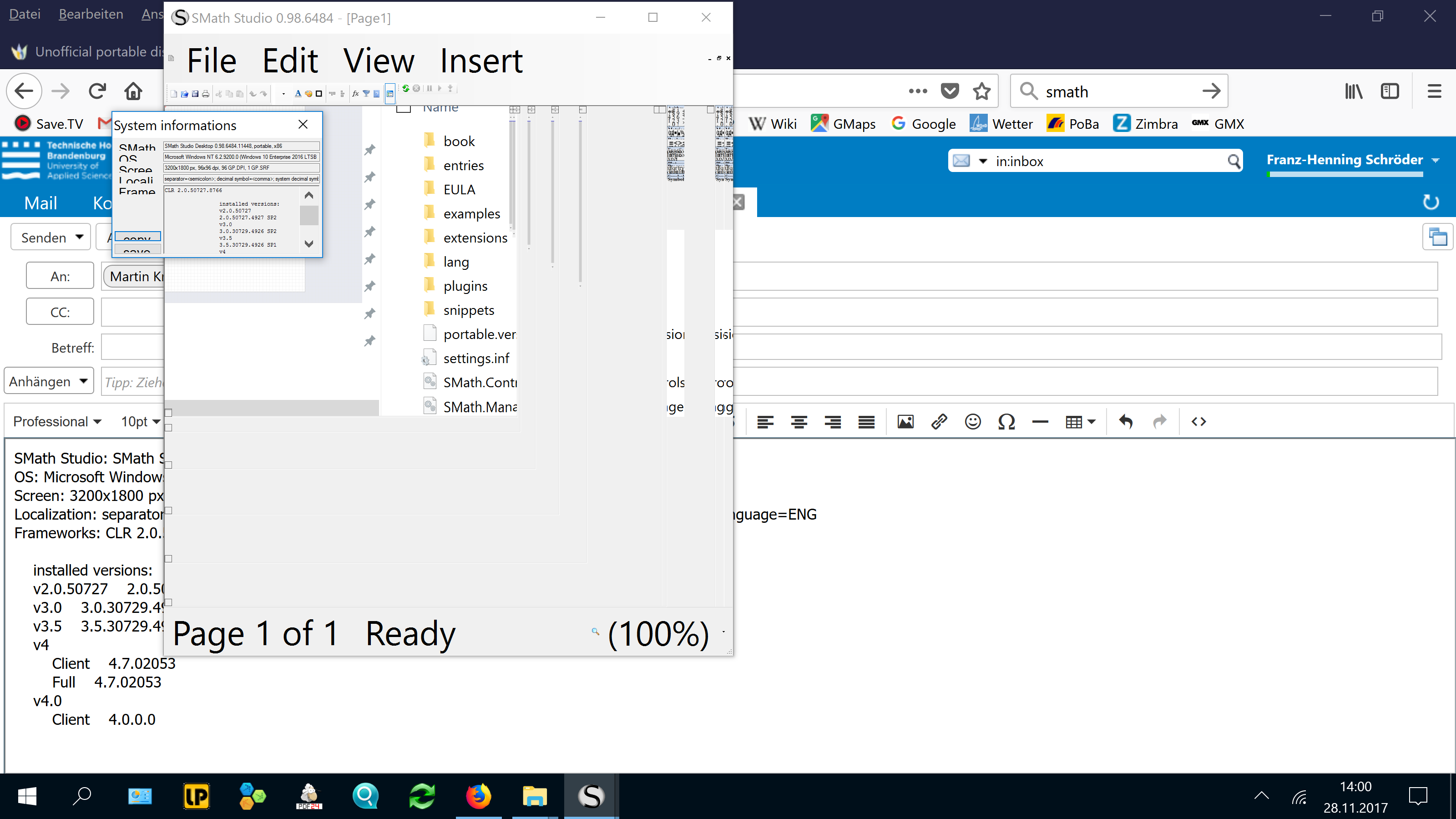

A colleague of mine experienced problems with a high res screen:
SMath Studio: SMath Studio Desktop 0.98.6484.11448, portable, x86
OS: Microsoft Windows NT 6.2.9200.0 (Windows 10 Enterprise 2016 LTSB , x64)
Screen: 3200x1800 px, 96x96 dpi, 96 GP.DPI, 1 GP.SRF
Localization: separator=; decimal symbol=; system decimal symbol=; language=ENG
Frameworks: CLR 2.0.50727.8766
installed versions:
v2.0.50727 2.0.50727.4927 SP2
v3.0 3.0.30729.4926 SP2
v3.5 3.5.30729.4926 SP1
v4
Client 4.7.02053
Full 4.7.02053
v4.0 Client 4.0.0.0
BTW, he also downloaded build 6528. This worked but he couldn't change any option (recoverable soft crash)
99% this issue is about the image edit region plugin, I think the fix was compiled and published just for the latest nightly build; remove it and everything should looks as expected.
If you mean the options in the settings it might be one of the issues already reported in the dedicated topic (otherwise he should be more precise)

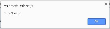

OBS: Button "THANK" not work for me. i use Google Chrome
It should be because some sort of antispam filter in the forum, once you have enough posts (or thanks?) it should works.
see the attachment:
en.smath.info.says:
