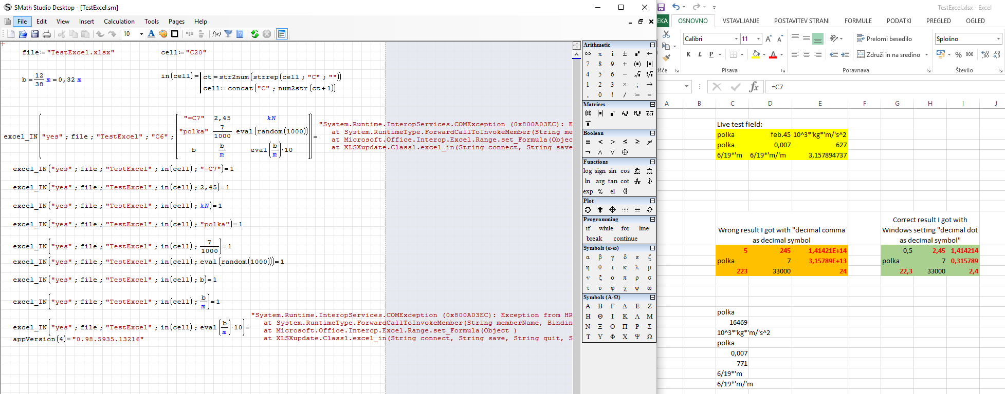

Thank you very much, but I am sorry to report that the test example I sent in previous message produces COM exception when testing with plugin version 0.2.0.14035. The only difference is plugin version. TestExcel.sm file with plugin version 0.2.0.11351 works correctly (but, as expected, with bug), when I change to plugin version 0.2.0.14035, I got a message as you can see below. If it helps: When trying with newer version -- Excel file is opened correctly, after that I got an error in Smath and excel file is not updated. At my computer is quite repeatable -- no other change than plugin version is neccessary to reproduce.
Smath version: 0.98 build: 5935
Excel version: Microsoft Excel 2013 (15.0.4805.1001) 32 bit

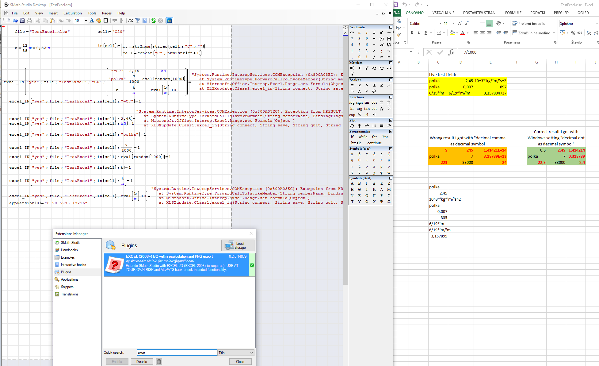

Here are results from me. I tried to give you similar information as you. I don't see any pattern. :-(

There is a pattern and solution to your issue.. As you can see 0.007 transferred into excel because it was represented as a "=7/1000".
This is not the approach I would like to go though, so I will try few things first.
I have already updated a plugin to v .14879, see if it provides a fix (and report)
If not I will get back to it sometime midweek

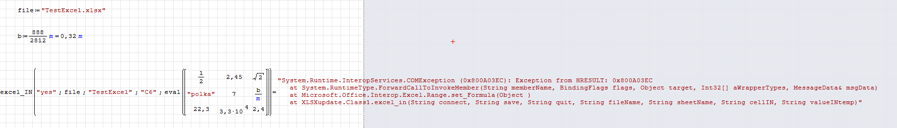

Yes. After I sent a message, I saw this detail. It seems that problem exists when it is neccessary to transfer "real floating" (not fraction) number. Unfortunately plugin version .14879 does not help:

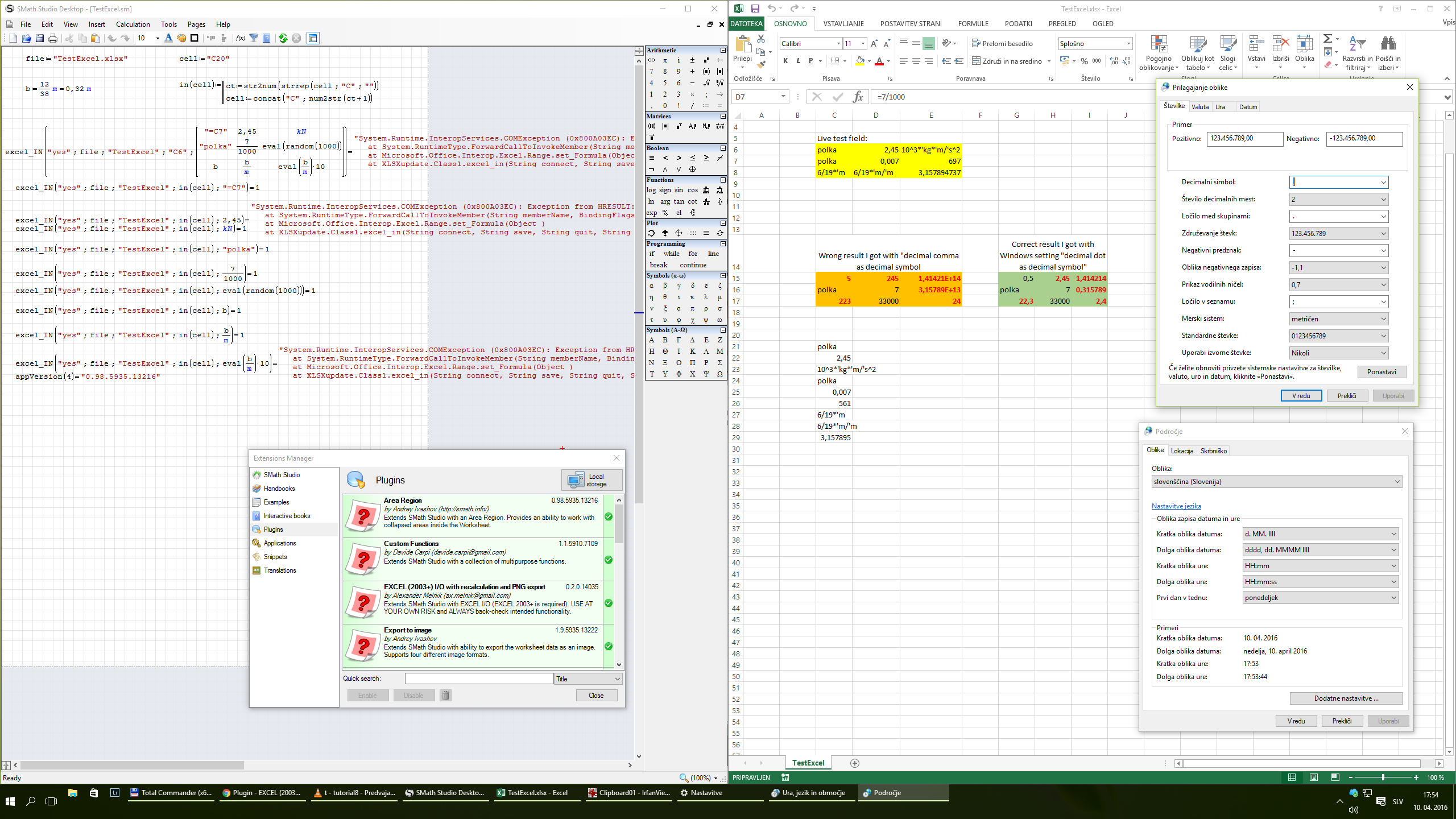

Here is the result. In order to be much clear what is transferred and what is not I deleted target cells in TestExcel.xslx before opening TestExcel.sm. As you can see, 2.45 is reported as transferred, but value in Excel is incorrect. Last value (eval(b/'m)*10 still didn't go through.Test Excel3.png

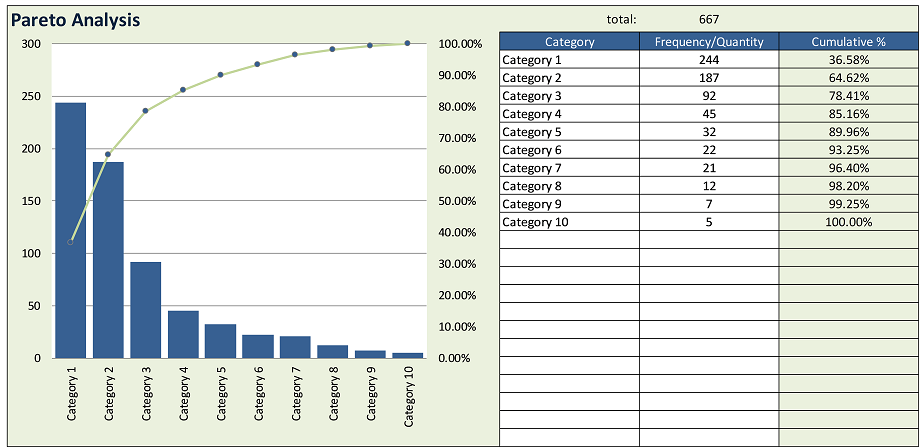

Why is this important? User can display visual feedback of EXCEL I/O with virtually no loss in performance. This is useful for visual check of I/O values not only by user but also by anyone who can visually see the printout of SMath workbook.
Export of pixel perfect EXCEL charts is now an option as well.
Function excel_PNG() was modified to take 5th argument – the font size of excel range table headers (set to 0 if none). Functions excel_PNGv0 and excel_PNGv2 are obsolete, however kept for the sake of backward compatibility.
