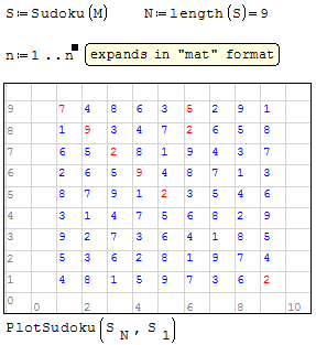

Hi. This other version stores all the intermediate steps in the brute force algorithm, but I fail trying to animate it. Hope someone else can do it.
SudokuBruteForceAnimated_lyles.sm (23,48 КиБ) скачан 1111 раз(а).

Thanks Alvaro for that gorgeous piece of work !
The "mat" style [n:=1..9] may have other applications ?
As it looks: left over from very original Smath versions.
In many instances SS 5346 needed mat2sys conversions

It's not an animation, but adding a Slider Region makes it easier to see solutions
SudokuBruteForceAnimated_lyles_raz_s.sm (25,18 КиБ) скачан 1085 раз(а).
Thanks Sergio ... near to RIP [I mean Sleep in Pace]
