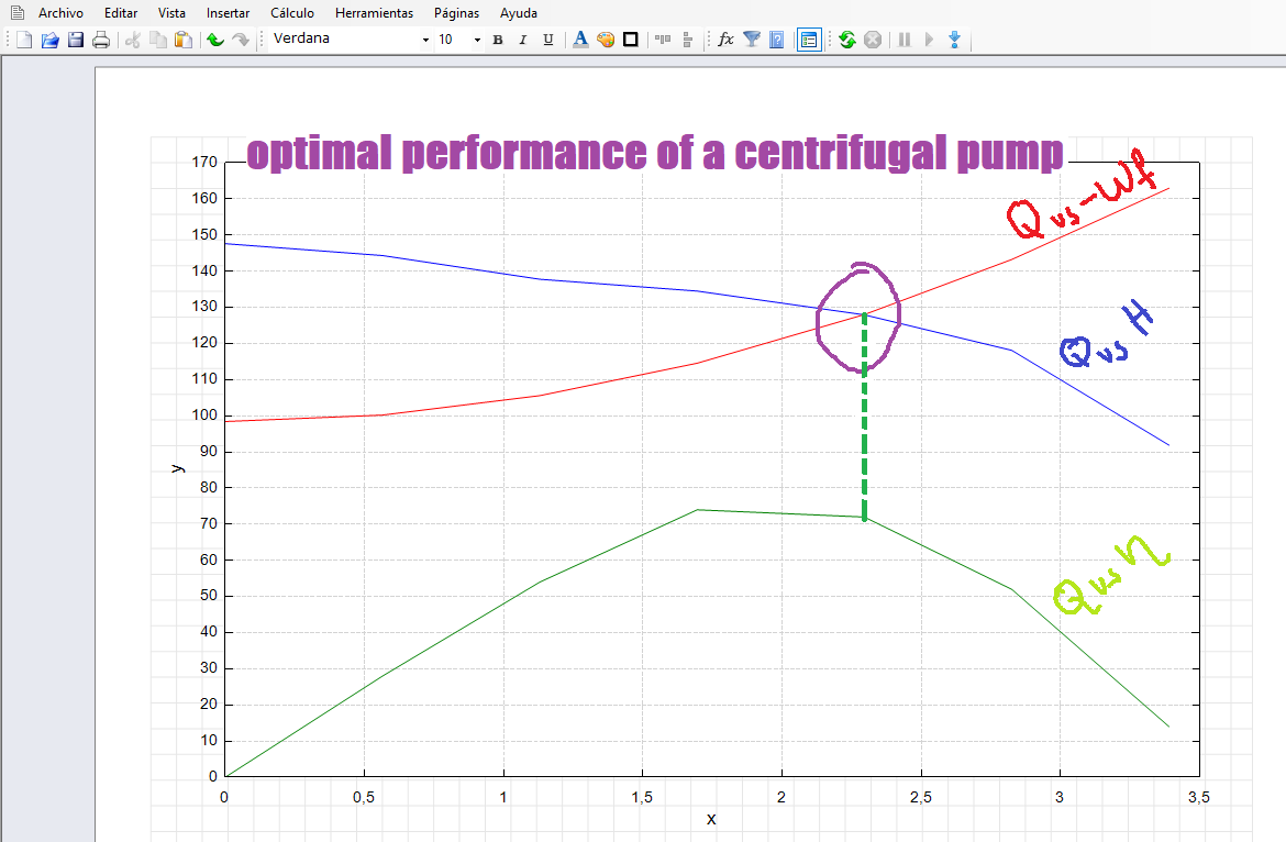

Hi guys
I was doing a simple exercise to find the sweet spot of a centrifugal pump and when I want to find the value of the intersection of two curves ... I have no idea how to do it.
also ... with that result of the intersection of the first curves I want to intersect another curve.
I tried "Linterp" and "Cinterp" but I was not successful.
centrifugal pump.sm (613 KiB) downloaded 72 time(s).
[albumimg]1646[/albumimg]
thanks guys, you are so cool

#2 Posted: 10/1/2021 8:20:58 AM
Looks like a syntax problem only.
Q, H and WF are already in vector format, no need to place an additional vector "placeholder" inside cinterp.
See attachment.
Bye

#3 Posted: 10/1/2021 6:50:36 PM
WroteLooks like a syntax problem only.
See attachment.
Bye
centrifugal pump.sm (615 KiB) downloaded 88 time(s).

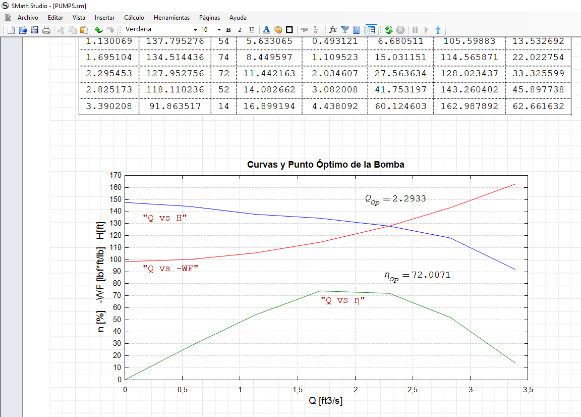

Thanks friend
I was very sad to see my error xD, it is like "it does not come out because you made a mistake in a + sign" lol
Here I leave the file with a little more detail, in case anyone is interested.
PUMPS.sm (626 KiB) downloaded 74 time(s).
