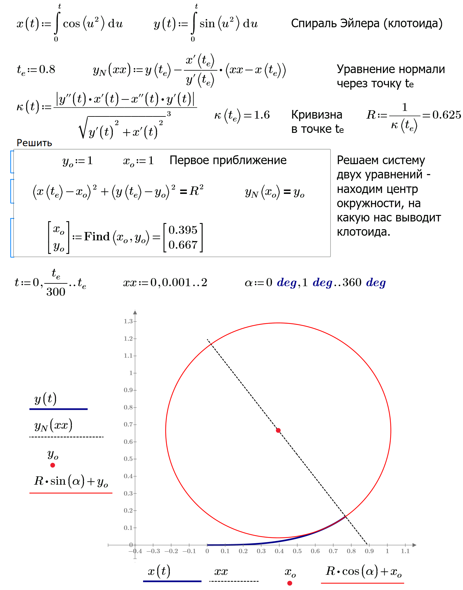

How can I do it in SMath
Edited 5/17/2025 7:14:32 PM

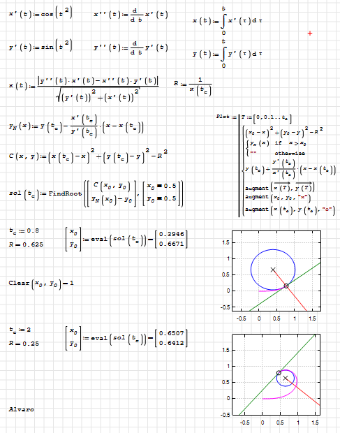

Hi Valery. This could be a way.
Euler-Spiral.sm (23.92 KiB) downloaded 1587 time(s).
Edited 5/19/2025 6:48:22 AM

Animating.
Euler-Spiral Forum.sm (33.9 KiB) downloaded 1565 time(s).
