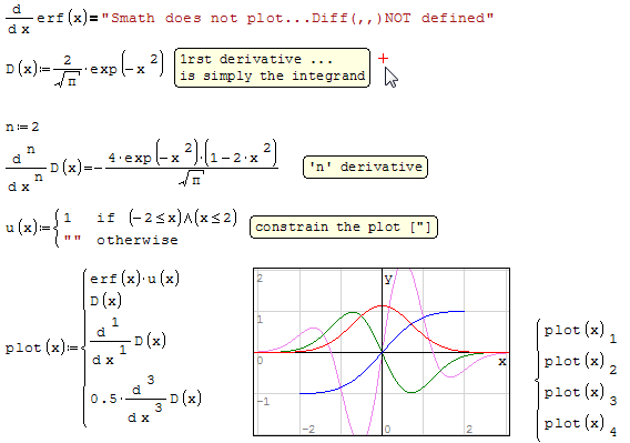

An attemp to use Leibnitz differential notation.
differentials.sm (53 KiB) downloaded 97 time(s).
differentials.pdf (93 KiB) downloaded 107 time(s).

#4 Posted: 12/5/2019 2:33:17 PM
983 likes in 6866 posts.
Maybe there are more reluctant functions ?
