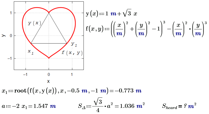

Solve with 4 args
Solve with 4 args - Is it a bug? - Messages
#1 Posted: 7/15/2026 7:34:36 AM
Valery Ochkov
Valery Ochkov
66 likes in 697 posts.
solve(4).sm (110.53 KiB) downloaded 803 time(s).

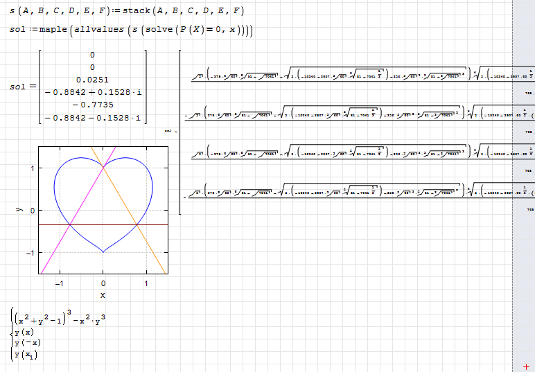

#2 Posted: 7/15/2026 11:14:15 AM

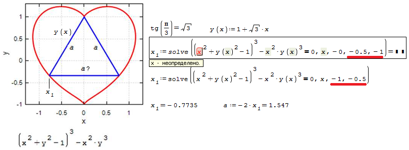

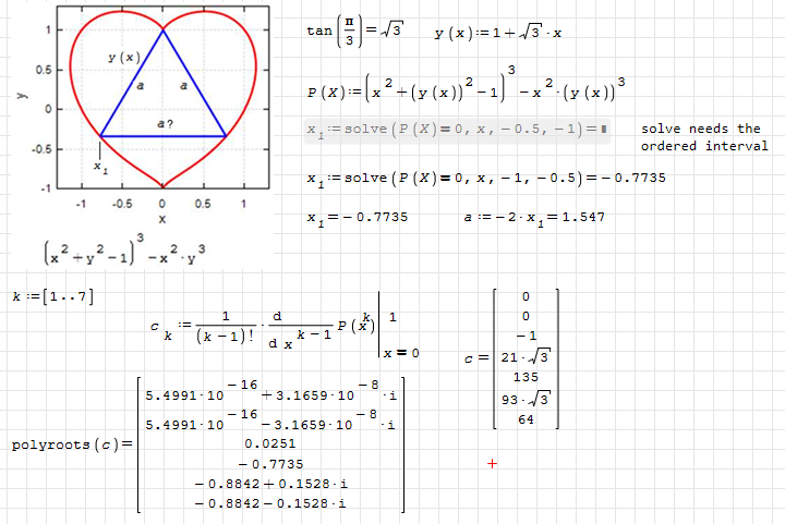

Hi Valery. It seems that solve doesn't know how to order the interval.
The 6 solutions numerically
And symbolically
solve(4).sm (158.3 KiB) downloaded 814 time(s).
#3 Posted: 7/17/2026 7:17:36 AM
Valery Ochkov
Valery Ochkov
Thanks, Alvaro
It is one task from the article
https://disk.yandex.ru/i/59sq-AYpKky-3Q
Edited 7/17/2026 7:28:06 AM

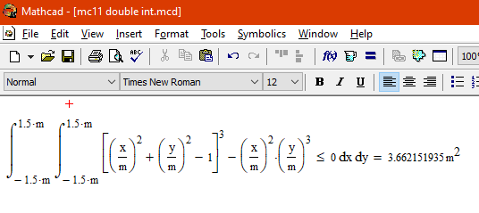

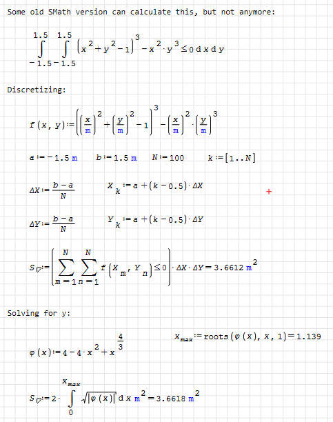

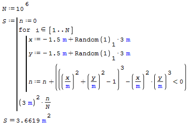

#5 Posted: 7/25/2026 3:50:39 PM
Hi Valery. Two ways.
heart area.sm (13.36 KiB) downloaded 762 time(s).
Mathcad 11:
mc11 double int.mcd (4.77 KiB) downloaded 757 time(s).
Edited 7/25/2026 5:52:57 PM

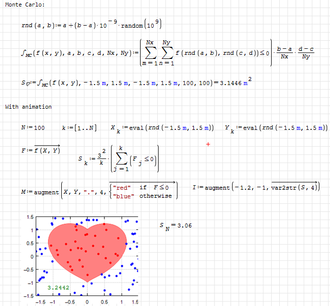

#6 Posted: 7/25/2026 7:20:52 PM
Valery Ochkov
Valery Ochkov
And what about this. We can create an animation.
Edited 7/25/2026 7:47:21 PM
#7 Posted: 7/26/2026 2:28:14 AM
It's possible, although speed isn't one of SMath's main features. And with so few points, there isn't much accuracy.
heart area.sm (26.99 KiB) downloaded 758 time(s).

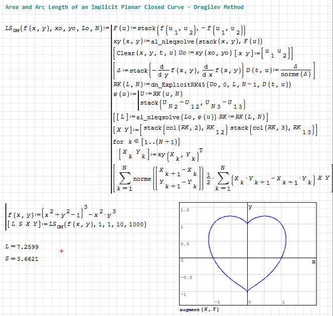

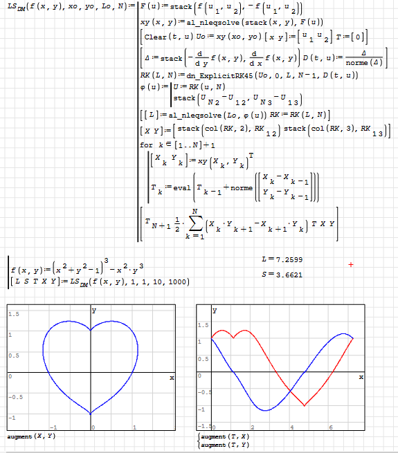

#10 Posted: 7/27/2026 1:25:09 AM
Using Dragilev Method.
Area and Arc Length of an Implicit Planar Closed Curve - Dragilev Method.sm (16.28 KiB) downloaded 765 time(s).
Edited 7/27/2026 1:33:24 AM
Valery Ochkov 7/27/2026 6:01:49 AM, Вячеслав Мезенцев 7/27/2026 1:28:37 PM
#11 Posted: 7/27/2026 1:27:20 PM
1,555 likes in 1,867 posts.
Yes, something like this with the Gaussian area formula.
ioan92 7/28/2026 11:13:51 AM
#12 Posted: 7/28/2026 8:24:46 AM
Hi Viacheslav. In that case, I'd like to point out that dividing by the norme (Δ) means the curve is parameterized with respect to arc length, and that if you're going to improve the points using the original function, you must also do so with the parameter variable, which in the program's notation is T. This is because Dragilev's method ultimately obtains the parametric expressions x(t) and y(t) from the implicit function f(x,y) when starting from a point (xo,yo) on the curve.
This is one way to correct the arc length given by T if you choose to improve the curve points, although there must be better methods involving splines for curves in the plane, not just single-valued functions. There are also better approximations for the area enclosed by the curve; the one used here is simply the area defined by a closed polygon.
Area and Arc Length of an Implicit Planar Closed Curve - Dragilev Method.sm (17.78 KiB) downloaded 259 time(s).
Edited 7/28/2026 8:36:40 AM
