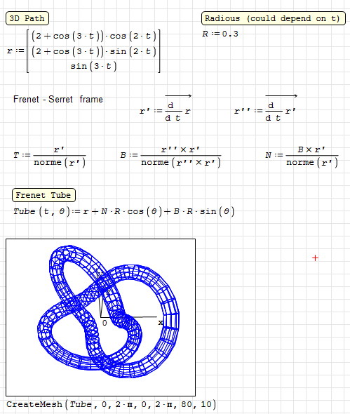

#1 Posted: 2/9/2023 7:11:59 PM
598 likes in 1,380 posts.
Parametric plot of curve and (2-3) trefoil knots.
What would be really cool would be a meshed torus.
However, I don't know any idea how to do that.
trefoil.sm (12.84 KiB) downloaded 1524 time(s).

#3 Posted: 2/10/2023 12:36:26 AM
Trefoil torus, not ordinary torus.
#4 Posted: 2/10/2023 3:03:35 AM
Hi Overlord. You can try starting with something this:
Frenet Tube.sm (9.22 KiB) downloaded 1501 time(s).
