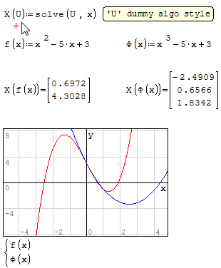

Useful for collecting multiple sets of solutions.
Solve Algo Style.sm (4 KiB) downloaded 80 time(s).

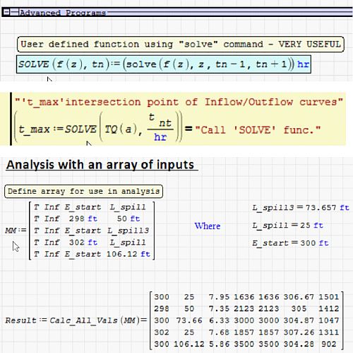

A similar approach used in the attached example.
Small Dams Flood Routing Ex-Program Method-Original-Simple3-R4.sm (1 MiB) downloaded 83 time(s).
Thanks Collab, great project
Page2 NDTMA.sm (88 KiB) downloaded 71 time(s).
