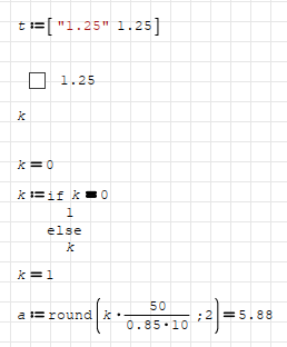

Hello. Important coefficient k=1.25. Sometimes you need to use it, sometimes you don't need to use it.I decided to take CheckBox. Here's what happenedFile not found.
I tried another way. I changed the formula using inactive check (K=0).Result is good with inactive checkFile not found.
But the result bad with active checkFile not found.
Question 1: Why did it happen?
Question 2: When inactive check, k=0.How can do k=1 with inactive check?

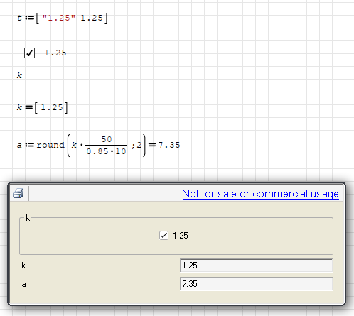

Answer 1: It is a long lasted bug/limitation.
SMath Viewer doesn't respect your decimal places in Smath Studio.
I had reported it 6 years ago, maybe it can't be fixable as it is.
https://en.smath.com/forum/yaf_postsm35182_SMath-Studio-0-98-6077--21-August-2016.aspx#post35182
However, you can round your results as you wish.
Answer 2: What I understood from your desire is;
If checkbox is active, then result should be matrix value.
If checkbox is inactive, then result should be 1.
You can do that with an if/else statement.

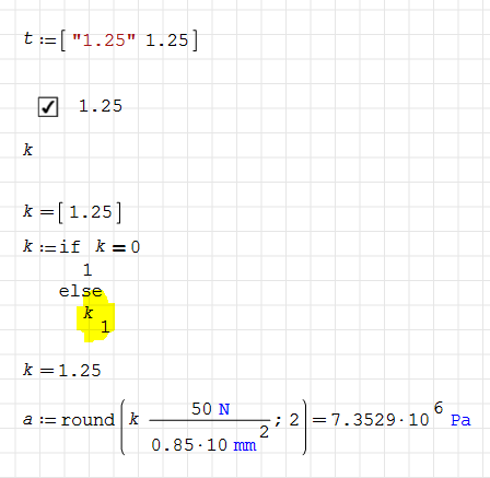

When adding units, the result has changed. When checkbox is inactive, everything is fine. When checkbox is active, units disappear.

1. your example
2. Davide Carpi tutorial 8 years ago.
Cheers ... Jean.
Maths checkbox.sm (22.86 KiB) downloaded 1181 time(s).
Maths checkbox DAVIDE.sm (18.66 KiB) downloaded 1198 time(s).
If you have noticed, when checkbox is selected k is in vector and look like k=[1.25]
Alter the if/else statement as below.
