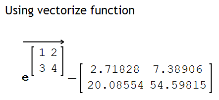

Matrix exponential is not implemented.
You can replicate in SMath what the Maxima engine does with the vecotrize() function (otherwise by default SMath tries to perform a scalar operation and fails).

But still the SMath result is not the same as the Mathcad result...

I think it's because as Davide said, Matrix exponential is not implemented in SMath. But then how to calculate the Matrix exponential in SMath? There is a way somehow?

This is the answer via wolfram alpha:
Is the same obtained via vectorize function on SMath. Maybe your file or configuration on Mathcad have some parameters you are not mentioning?
