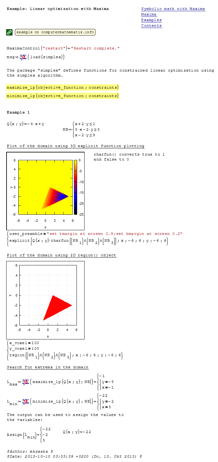

You can use the "simplex" package in Maxima (linear optimization)
See page Examples> Maxima usage> Linear optimization in the interactive handbook.
Example maxima linear optimization.sm (41.89 KiB) downloaded 1128 time(s).

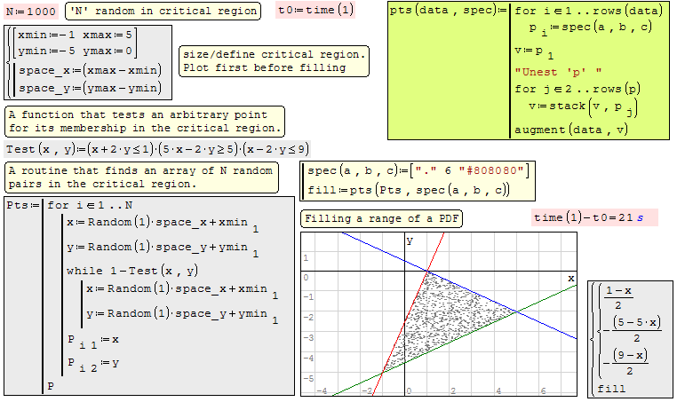

#3 Posted: 12/19/2017 9:12:22 PM
How will you go about solving following problem in Smath
Maybe plot the problem 1rst ?
Next solve solely with Smath, whereas Maxima is not component of stable 6179.

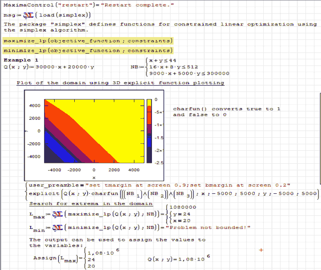

Thanks for the answers Jean would you be kind enough to attach the .sm file too. For field engineers like us your math skills seems rather cryptic & is digested properly after 2/3 days of experimenting
#5 Posted: 12/20/2017 11:59:15 AM
Here is + some extra stuff. Maybe there is way to draw an inscribed 3D ?
Solve GivenFind Critical Region Copy.sm (39.35 KiB) downloaded 1169 time(s).

CBG
CBG
78 likes in 312 posts.
Using Smath Studio with Maxima and the example of Martin Kraska.
Metodo_Simplex.sm (52.26 KiB) downloaded 1164 time(s).
