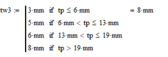

All,
I am new user, need your help how to create this type of equations in Smath

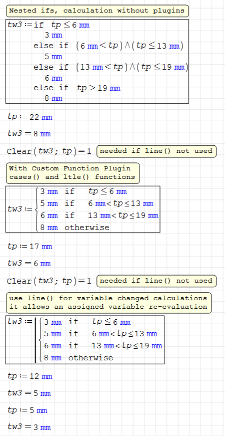

#3 Posted: 6/15/2023 11:42:20 AM
NDTM Amarasekera
NDTM Amarasekera
130 likes in 352 posts.

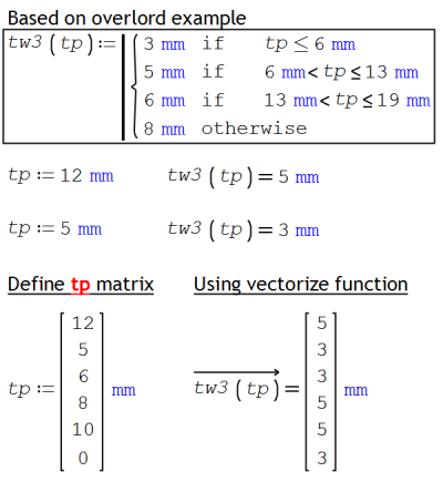

Based on program by overlord.
if_function_ndtma.sm (27 KiB) downloaded 66 time(s).

... from the drop down fx menu.
#6 Posted: 6/16/2023 10:25:58 AM
554 likes in 1333 posts.
Making it a function as Amarasekera did is much more sensible solution.
