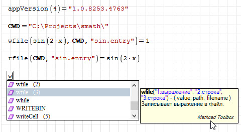

Yes, functions have moved to another plugin - Mathcad Toolbox.
You can also use the CWD variable.

Follow up question: rfile, wfile, dfile are only working with the default "user" path? No way to use these functions with a different path?
My goal is to be able to delete a file of my choosing in a path of my choosing.
Thanks in advance!
#4 Posted: 9/22/2022 1:57:49 AM
1403 likes in 1708 posts.
You can use wfile(3) and rfile(2) from Mathcad Toolbox plugin.
I can add dfile(2) for this.

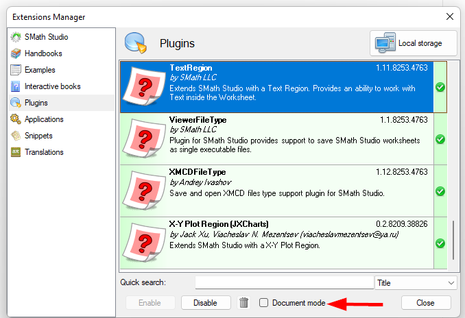

I think that if you start to idiot proof SMath, it will become as stupid as the users its designed for.
In the end, the path is not arbitrary, and its not like you are deleting entire directories, dfile(x,x) should be made to only delete specified files not folders.
The file would need to be chosen, so not arbitrary as it sounds.
Microsoft Excel for example is a much larger and commonly used program that allows for the same with only a single "enable macros" toggle.
We could do the same, withing the plugin that carries these file manipulation functions, have a toggle that enables these functions.
In this way, a user is not exposed unknowingly to these functions.
Similar to the way we enable document mode.
Just my two cents on the matter...
