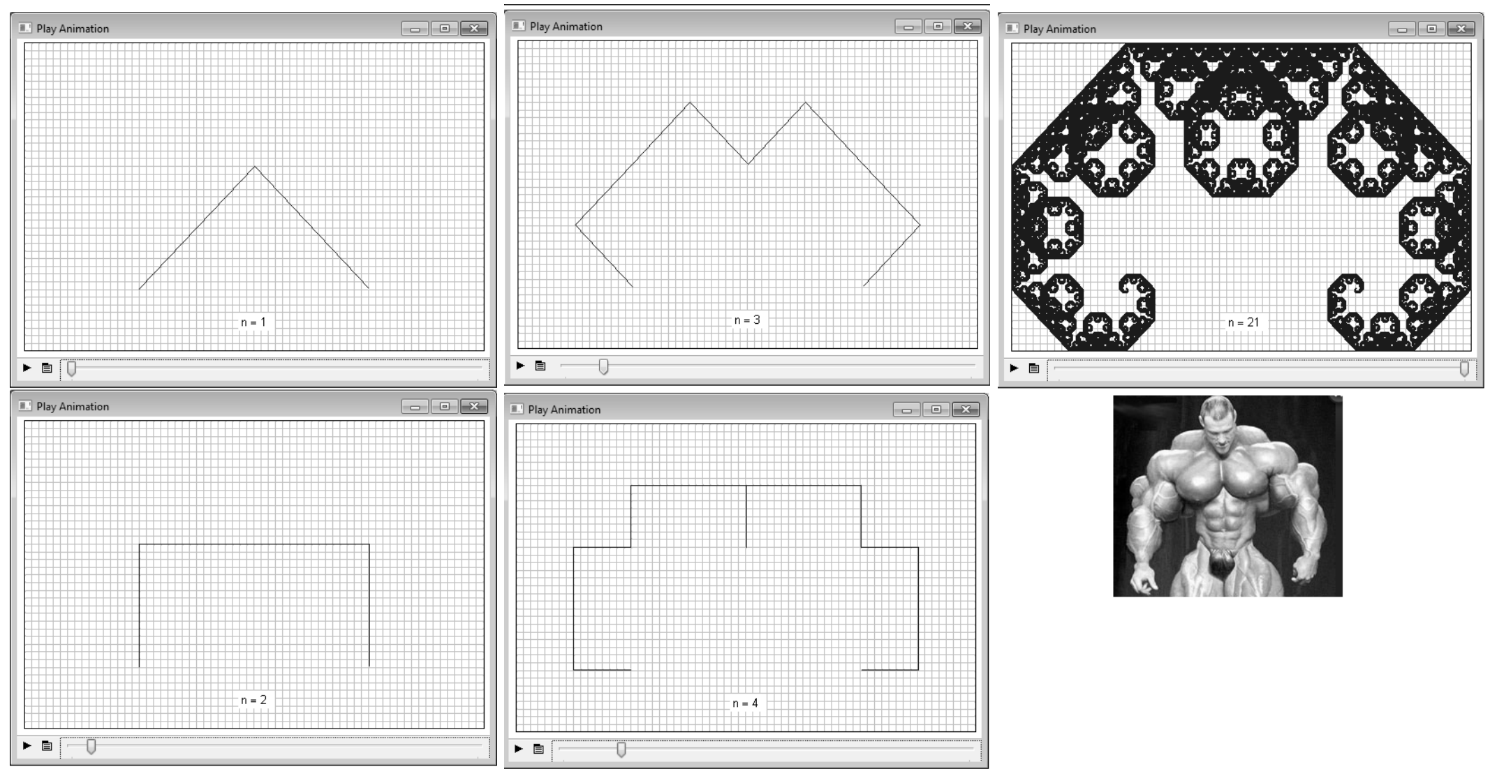

WroteCan we create this in SMath.

#4 Posted: 10/27/2023 9:48:23 PM
Я просил анимацию фрактала Леви.
А вы мне высыпали все, что у вас есть!

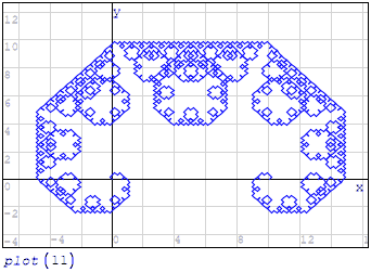

#6 Posted: 10/29/2023 3:48:15 PM
http://twt.mpei.ac.ru/MCS/Worksheets/Levy-curve.xmcd

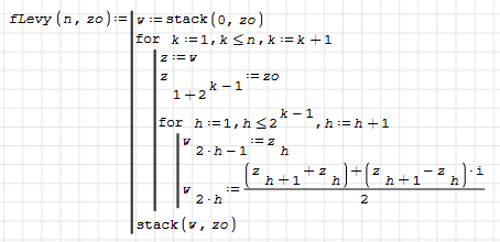

#9 Posted: 10/30/2023 3:32:18 AM
Wrotehttp://twt.mpei.ac.ru/MCS/Worksheets/Levy-curve.xmcd
Here is the smath file for that mathcad example.
fractal_levy.sm (9.99 KiB) downloaded 1324 time(s).

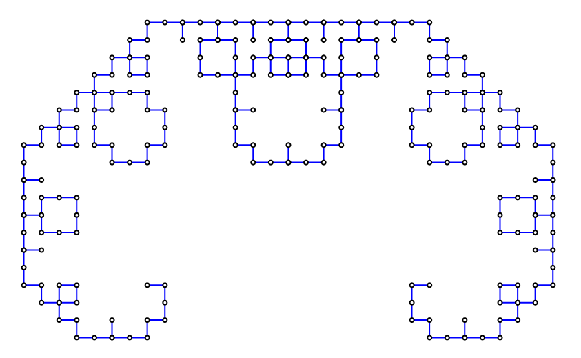

#10 Posted: 10/30/2023 12:42:54 PM
With n=0
Levy-Fractal.sm (12.3 KiB) downloaded 1330 time(s).
Did you seen Levi fractals by n<0 or n not integer?

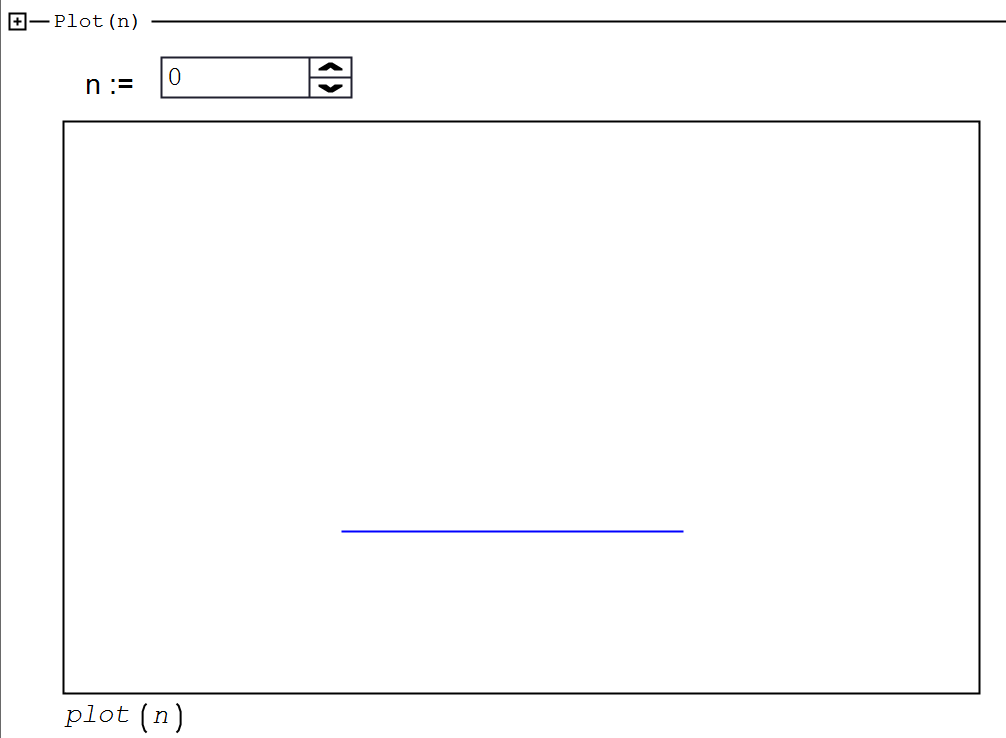

#11 Posted: 10/30/2023 4:09:10 PM
Here is your file with animation added...
Levy-Fractal_animated.sm (24.31 KiB) downloaded 1338 time(s).
