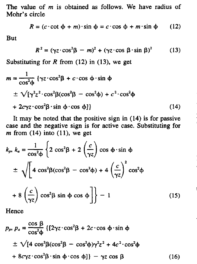

i want to solve below problem
m, ka, pa
i try to solve this problem
but i can't get result.
20230614_lateral earth pressure.sm (100.47 KiB) downloaded 1343 time(s).
Thanks in advance
m, ka, pa
Thanks in advance

Hi. Maybe the attached helps, but's hard to know. At the eqn 16 I count two open [ and only one closed ].
20230614_lateral earth pressure.sm (74.8 KiB) downloaded 1347 time(s).

My suggested solution is in the attached.
LateralEarthPressure.sm (9.05 KiB) downloaded 1273 time(s).

WroteMy suggested solution is in the attached.
Get more accurate solutions from roots(,,,)
LateralEarthPressure.sm (13.13 KiB) downloaded 1305 time(s).

Hi. Another way, plugin-less version. Have the advantage that can recognize the active and passive cases.
20230614_lateral earth pressure polyroots.sm (77.28 KiB) downloaded 1298 time(s).
