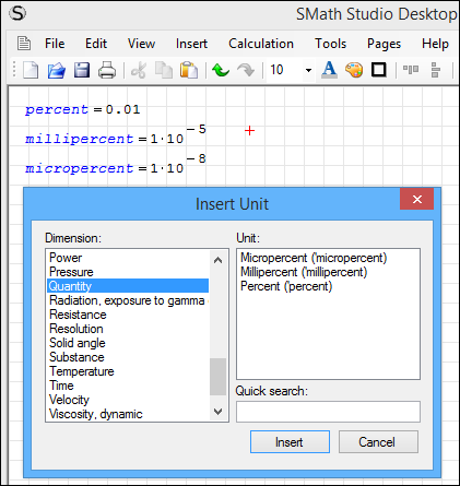

How can I specify the "quantity" dimension, with percent just being a unit representing the factor 0,01? I do not see a place for the word "quantity". Could you please give a template for percent, then I should be able to do the rest.
WroteHow can I specify the "quantity" dimension, with percent just being a unit representing the factor 0,01? I do not see a place for the word "quantity". Could you please give a template for percent, then I should be able to do the rest.
Here we can assume "quantity" is just a property. So, we can say 'percent' unit is dimensionless (it equals to 0.01). Note, based on Units.xml dimension for dimensionless units has id="613". Then, here is an example:

Note: screenshot taken from the newer build then available for download. In SMath Studio 0.97.5280 "quantity" units will belong to "Dimensionless" group.
