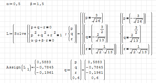

"Sometimes the Maxima function Solve can replace the Mathcad solution block, see attachment.
What is the problem with Maxima plotting? Please give an example of what you try and how it fails."

Thanks Martin,
I have remade Quaternion that will work independently of Maxima.
I'm puzzled reading the error message "forcibly" ?
Does it mean Andrey is no authorized to let Smath users to access Maxima ?
No way I could make Breather plot something like the 'Kuen' surface example.
You will understand all by reading the attached Smath WS.
Cheers, be good ... Jean

As to the error message: Do you use the portable version with maxima? (with everything pre-installed). Closed connection may happen if maxima is crashed.
Maxima can access gnuplot 3d functions, for examples have a look at the handbook section 5.1.
I can't reproduce the Mathcad plots, there might be translation errors between smath and maxima, but it works for the example from the gnuplot homepage given in the handbook (Kuen's surface, the function does not include hyperbolic functions)
At least, the attached sheet gives a starting point.
rot.sm (426.68 KiB) downloaded 1538 time(s).
