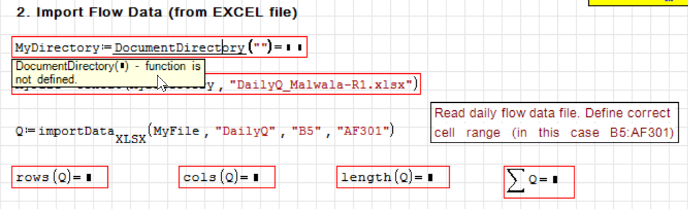

However, I get an error "DocumentDirectory(.) - function not defined", when trying to import an EXCEL data file.
Several attempts with clean reintallations did not work.
The SS file and Excel data file are attached.

#2 Posted: 7/22/2016 5:19:06 AM
2273 likes in 3738 posts.
Confirmed. My fault. Will fix later today.

#4 Posted: 7/22/2016 3:02:07 PM
Fixed. New beta version released.
