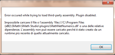

But seem that the framework is not compatible (.NET framework 4)... loading a plugin with a random function based on the math.net numerics plugin SMath disable the plugin (something like: "Can't load the assembly because it's created from a runtime newer than the currently loaded")
there is a way to bypass this issue?

I hope that Andrey can help you to compile this library, it is not compatible with windowsMobile (NET2.0) but I guess there won't be a new version for that platform.
Anyway this code or part of it might be adapted to NET2.0, I don't think it is worth the effort though.
