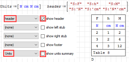

#1 Posted: 10/19/2023 3:46:44 PM
Question :
Please, is there now possible to insert one or more formatted labels into a matrix or into a table?o_o
In case where it is not yet possible, is there a way to make it possible?

#2 Posted: 10/20/2023 3:28:53 PM
Hi Ioan, nope, as for now is not possible. I might think about something.
ioan92 10/20/2023 4:13:00 PM
#3 Posted: 10/20/2023 4:29:10 PM
It is at least possible to put other regions into text regions. So in general, this might not be impossible. Yet, for now, it doesn't even seem to be possible to put more placeholder into custom regions. An important application would be Mathcad-like plots, where you have placeholders for the x and y values and for the axes limits.
For now I recommend to make use of tables with string-encoded SMath expressions. Whatever you can write or display in a formula region can be displayed in a table cell (with minor deviations like italic/roman style).
ioan92 10/20/2023 6:14:00 PM
#4 Posted: 10/20/2023 7:56:26 PM
WrotePlease, is it possible to insert one or more formatted labels into a matrix or into a table ?
Into a Table, don't know. Into a matrix YES..
1. Insert the Formatted Label, absent of title to see the decorative icon
2. Insert 1 x 3 matrix ... top/bottom 0,0
3. Brush over blue style the Formatted Label
4. copy/paste in the black center place holder.
In my example document, result Formatted Label evaluates.
Consequently, I have my numerical result of Convolution example.

#6 Posted: 10/20/2023 11:10:54 PM
WroteBonjour Jean,
Salut Ioan from the old days.
Please, confirm it works.
Take care ... Jean.
Image Formatted LABEL INSERT MATRIX.sm (22.52 KiB) downloaded 1338 time(s).
