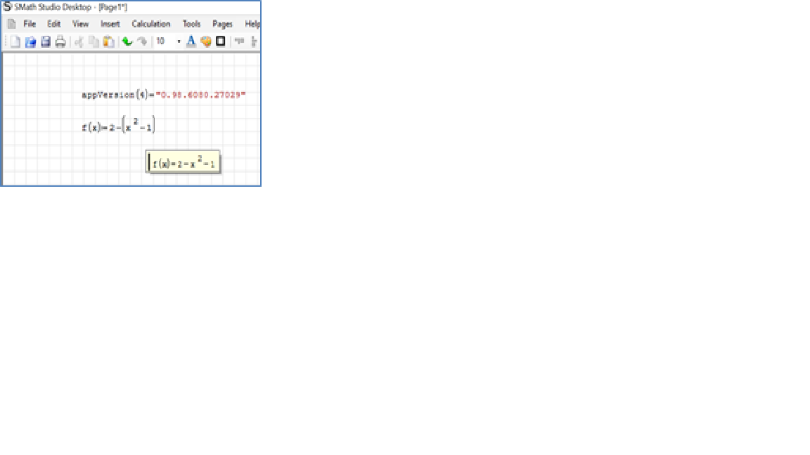

When the cursor is over an equation, it shows the long version of it. However, the tooltip equation (with the yellow background) misses often brackets, which makes the equation wrong. See attached:tooltipproblem.png

#3 Posted: 8/22/2016 12:38:44 PM
2273 likes in 3737 posts.
Thank you! Will fix it asap.
#4 Posted: 8/22/2016 12:47:19 PM
Fixed. Will not be an issue anymore in the next SMath Studio release.

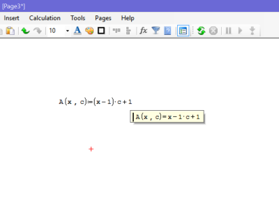

Tool tips problem.
Tooltip.pngTool tips problem
#6 Posted: 8/25/2016 4:55:03 PM
Fixed: http://en.smath.info/forum/yaf_postst7719_SMath-Studio-0-98-6081--25-August-2016.aspx
#7 Posted: 8/25/2016 4:56:20 PM
NDTM Amarasekera
NDTM Amarasekera
130 likes in 352 posts.
Thank you Andrey!
It works fine
