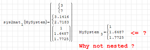

#4 Posted: 12/21/2015 8:45:51 PM
Nice work, as usual
Unfortunately, this happens...
I've made this proposal, anyone who want to support/improve it, you have to register in the Bug Tracker System.
BTW seems you have found something that I have to change...

#5 Posted: 12/22/2015 11:51:20 AM
Thanks Davide for visiting and commenting. The "Why not nested" is simply because on closing,
either XP or Smath don't save the work sheet settings, completely.
I know about Autocad "AutoSave" but don't use AutoCad.
In my case, I didn't try XP Restore because of the time inprecision: it might have done nothing !
On delicate work sheets like "Matrix Treasury" I also save as copy,,, that one was scrapped too !
Your "AutoSave" proposal [link above] is quite welcome. Now convince Smath Developpers.
