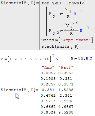

I was wondering whether it is possible to change the unit of a matrix element within a for loop.
Here is a small example:
Example
I would like to change for example the Current and Power unity to mA and mW respectively.
Thanks in advance

Subjectively better looking version for Razonar's example.
Not very practical though, need to re-write for every new units.
I think this should be a feature, using a matrix units for matrix output.
This is how I wrote a pseudo 'matrix looking like' variable.
'\005B\ohm\0020\mA\0020\μV\005D\
Rest is copy paste to place holders.
matrixunits.sm (3.49 KiB) downloaded 1206 time(s).
