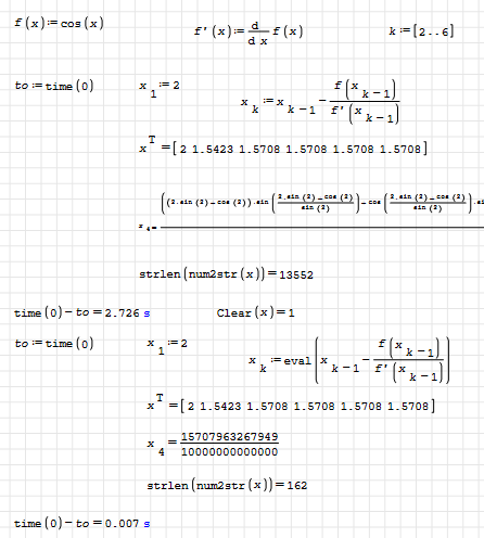

#3 Posted: 5/8/2024 4:01:03 AM
Wrote... When you have loops or complex calculation, the expression terms might stack in a very long equation. If you have a vector or a matrix, each element might contains a lot of them.
When the complexity arise, since an evaluation requires to retrieve each element from the memory, replace it, and perform the actual calculations, it might be useful to perform an eval() ...
Hi. This example can illustrate what Davide says.
using_eval.sm (19.85 KiB) downloaded 1551 time(s).
