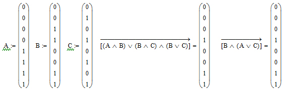

Unfortunately, as I am showing other students how to use logic, I wanted something simple for them to use. In Mathcad 15 it is easy to show an original expression, and alongside it a simplified expression resulting from using Boolean Algebra, and I was hoping that SMath Studio would do the same, as I do not expect my fellow students to pay for a copy of Mathcad. Unfortunately, SMath Studio does not have to option of a simple use for logic on vectors as does Mathcad 15 (see attached .jpg image from Mathcad 15 - I hope this works, as this is the first time I have tried to attach an image).

Eddie: like this !
Utilities Matrix Vectorise LOGIC .sm (44 KiB) downloaded 97 time(s).
Utilities Matrix Vectorise Friendly .sm (17 KiB) downloaded 94 time(s).

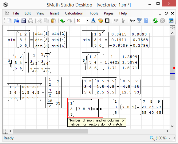

Regarding initial question: see vectorize(..) function into new nightly build release: http://en.smath.info/forum/yaf_postst7329_SMath-Studio-0-98-5908--05-March-2016.aspx
