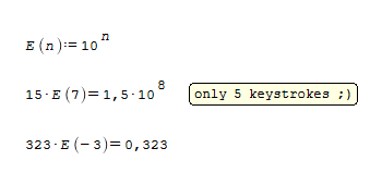

#7 Posted: 8/25/2020 9:40:39 AM
Make your own feature to suit peculiar project.
This notation is native in OriginLab.
Maths e(n).sm (14.94 KiB) downloaded 1085 time(s).

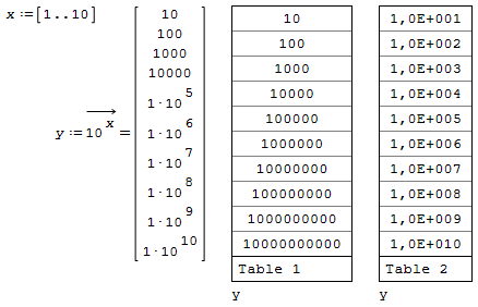

#9 Posted: 8/27/2020 11:49:20 AM
1,334 likes in 2,249 posts.
I do think it would also be good to consider (optionally) using the common exponent notation for display as it is much more compact in arrays. When an array is full of *10^3 it really blows out the size on the page.
How about the Table region?
sci.sm (13.5 KiB) downloaded 1114 time(s).

#10 Posted: 8/28/2020 2:31:05 AM
henry crun
henry crun
0 likes in 34 posts.
That's a useful solution. I see that when scientific is selected, however, that it loses the units.
Is the table plugin part of the closed source, or an open source add on that might be fixable?
[is it: https://smath.info:8443/!/#public/view/head/plugins/TableRegion ?]
However, I would just prefer to have numeric formatting work well in the first place.

#13 Posted: 8/29/2020 10:36:56 AM
It does not lose what's not specified.
Table Scientific.sm (20.56 KiB) downloaded 1139 time(s).
