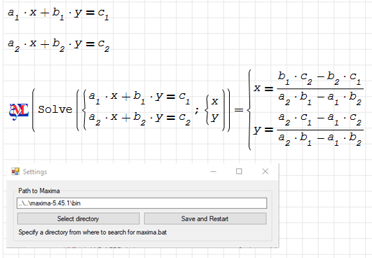

Such as this
a.1*x+b.1*y≡c.1
a.2*x+b.2*y≡c.2
How to get symbolic results for x and y
1.sm (3.01 KiB) downloaded 1256 time(s).

Hi, It's posible whith Maxima Plugin
netsonicyxf 2/12/2022 10:27:00 PM
#3 Posted: 2/12/2022 11:38:38 AM
Make it immediately usable.

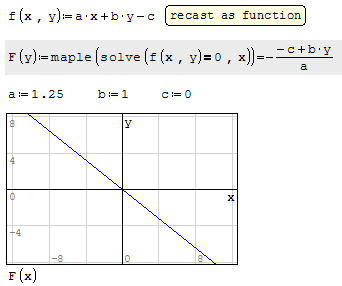

#4 Posted: 2/12/2022 11:55:56 AM
... get lot more from maple companion.
ODE Symbolic Verhulst [Logistic].sm (25.55 KiB) downloaded 1073 time(s).

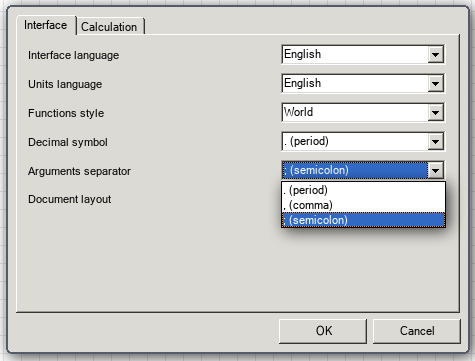

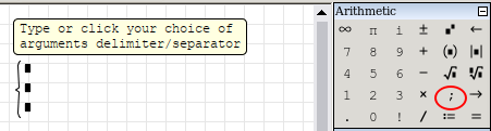

#9 Posted: 2/13/2022 11:27:27 AM
598 likes in 1,380 posts.
How to input more than 2 equations in Solve after curly brace?
There are only 2 placeholders by default.
This includes expanding vectors, adding new arguments to functions, etc.
netsonicyxf 2/13/2022 11:28:00 AM
