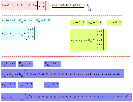

#1 Posted: 11/12/2018 5:37:38 AM
Hi. Is that ok?
range_issue.sm (2.74 KiB) downloaded 1204 time(s).

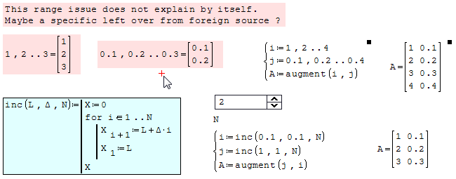

#2 Posted: 11/12/2018 9:05:58 AM
Hi. Is that ok?
Certainly NOT for use.
range_issue(1).sm (8.12 KiB) downloaded 1226 time(s).
#3 Posted: 11/12/2018 1:34:39 PM
Is that ok ?[/quote
... doctored otherwise from undefined 'zero' in Smath.
rangeissueDoctored.PNG]
#4 Posted: 11/12/2018 8:48:51 PM
Second argument isn't guaranteed in results, as reported in the function description. The reason (as shown by Jean) is that the calculated increment value and/or the results might introduce a small error. We might see if can be somehow improved, though.

#5 Posted: 11/13/2018 1:57:27 AM
Thanks Davide ... Reconciliation as demonstrated.
