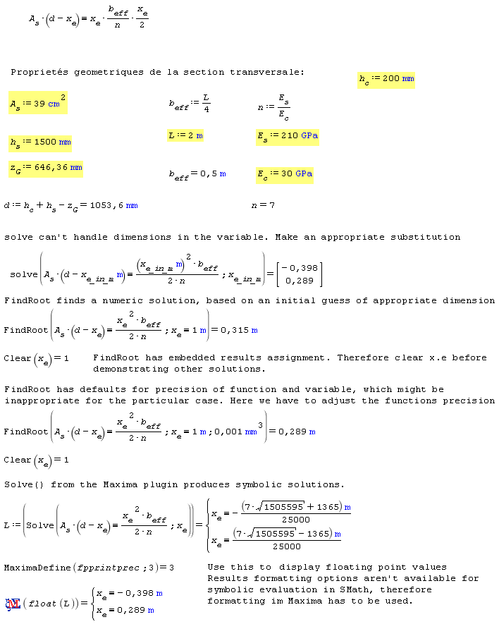

solvers.sm (17.78 KiB) downloaded 1441 time(s).
6 users liked this post

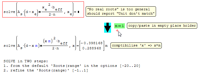

"NO real roots" from the solve bloc is an absolute pest [not to say stupid].
SMath_equation solver test (1).sm (11.49 KiB) downloaded 1403 time(s).

Type x*'m or x* and then insert the unit from the dialog into the empty placeholder in the right of the multiplication dot.
Multiplication operators in front of units aren't shown.

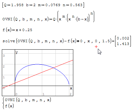

Always plot first ...

I somehow missed the option to use the 2nd solve function with root limit, but I didn't need a plot for this, so I used it in one line and everything worked out fine.

#18 Posted: 12/29/2019 11:01:26 PM
If you don't plot, you will soon hit the wall.
That will help set the limits.
When applicable, "implicit roots" is often + accurate.
