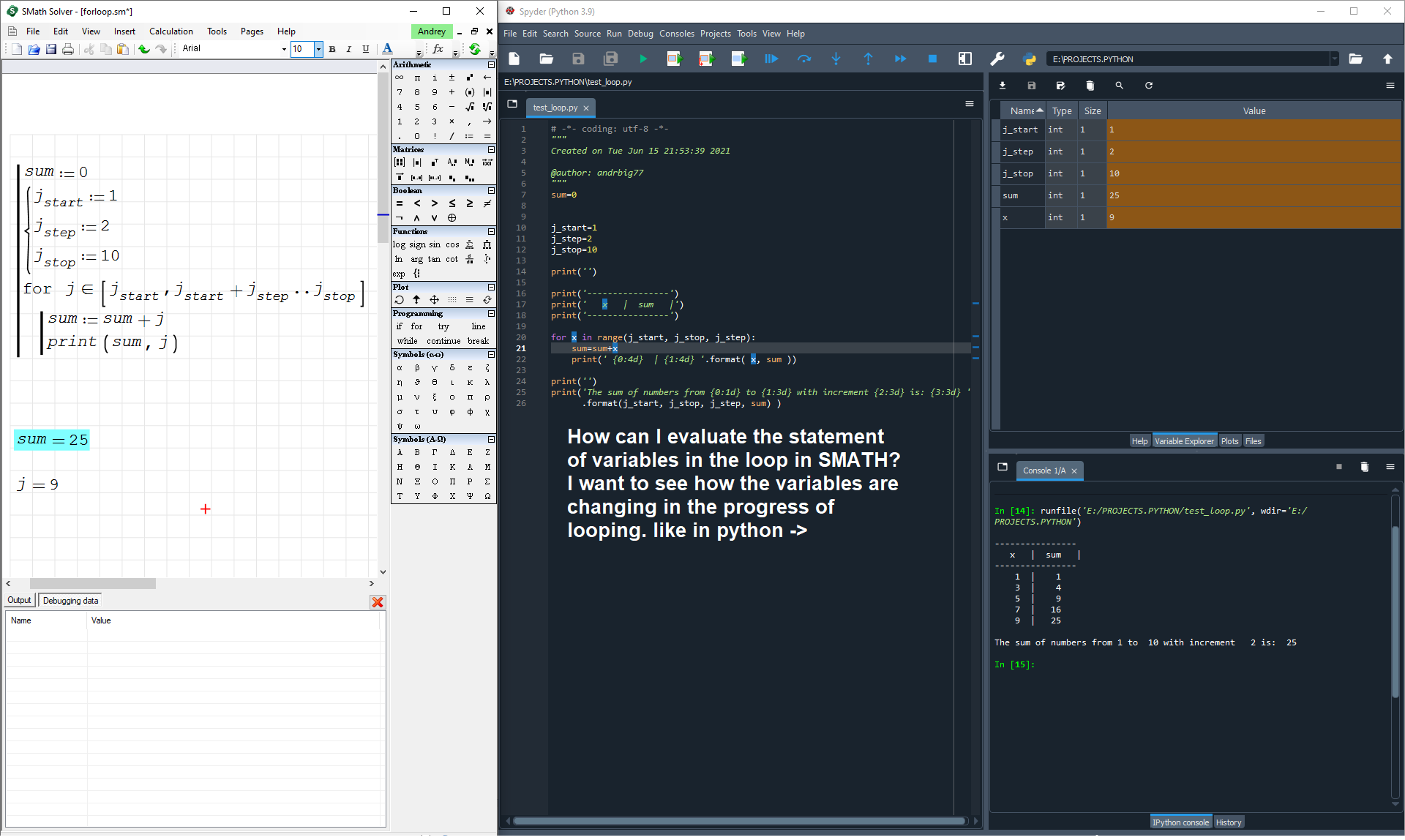

Dear Smath-experts,
How can I evaluate the variables in the loop in SMATH?
I want to see how the variables are changing in the loop like in python.
Is what debug is for, but how does it work?
Best regards,
Andrey
#2 Posted: 9/10/2021 9:40:07 AM
You can either use the function trace() to show some specific variables (data will be shown in the "output" window on the fly without stopping evaluations) or use the debugger. This is more in "Visual Studio IDE style" and shows you the whole context in a specific point (the breakpoint); this means that the execution is paused when those points are evaluated. To add/remove a breakpoint you can use the context menu (mouse right-click)

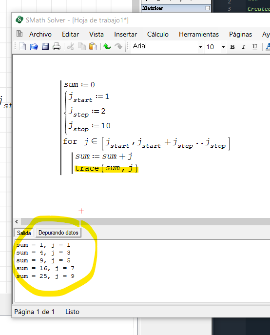

#4 Posted: 9/10/2021 5:28:15 PM
Oscar Campo
Oscar Campo
135 likes in 309 posts.
Dear Smath-experts,
Best regards,
Andrey
Hi Andrey, you can use trace() for check how variables are changing in the loop:
Oscar

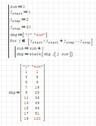

#8 Posted: 9/11/2021 10:37:47 AM
598 likes in 1,380 posts.
trace() or breakpoints are usually de-facto way to go.
Alternatively you can store variables to a matrix.
