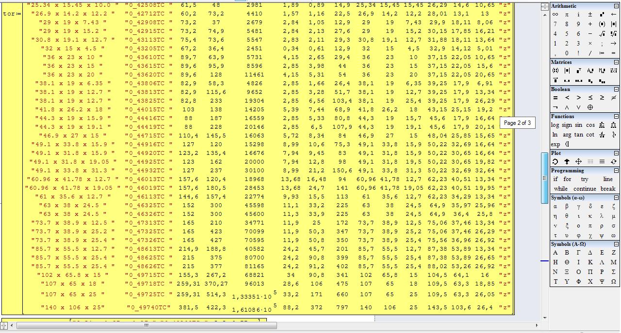

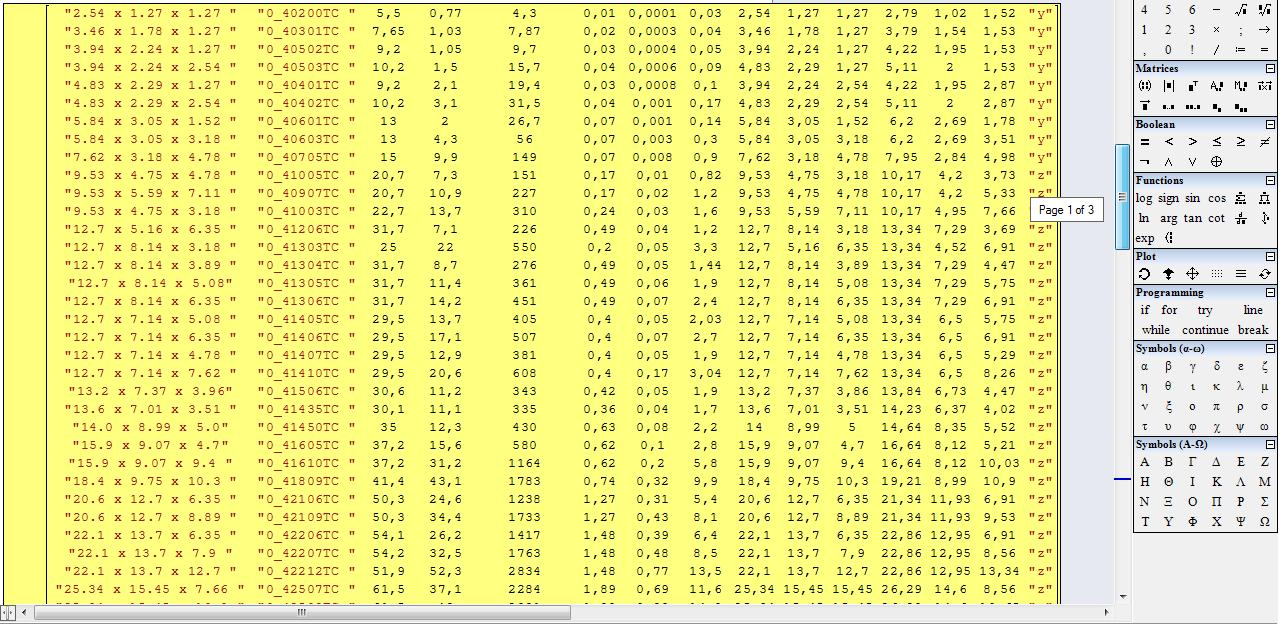

Because in my calculations, I have often stored large matrix data, I started from this aspect and I wondered how I could make a very large array (let's say, for example, format 100x25) to reduce it to a negligible space while keeping all the data stored in it at that time? Is this possible? How to proceed? I would like examples from experts in the field. Thank you.

I am referring specifically to matrices containing input data that are made by definition equality. Above I gave an example of the 68x15 array, for which I used two screenshots. I have previously taken the example of a 100x25 format matrix. When defining such a matrix, SMath does not provide tools to reduce it to acceptable dimensions, as it offers when the matrix is ​​subsequently called through a non-definition equality. For example, if I have a matrix with combined data containing numeric values ​​and / or alphanumeric strings and / or matrix elements, then at the dimensions suggested by me, this array will extend over more than one SMath work page in both directions. It becomes very difficult in these conditions to subsequently edit the mathematical process, correlating the relationships that precede the matrix with those that succeed it. There is the possibility of closing such mammoth matrices in collapsible areas after mkraska's suggestion from where to be called by equality without definition. But if there are many such matrices inside a mathematical process, things will get even more complicated. That's what it is.

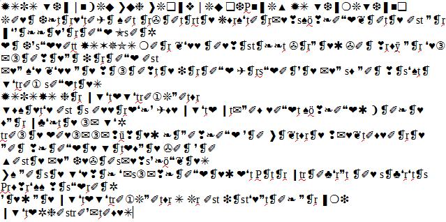

@mkraska: Trying to use the Google automated translator, using the copy-past method, I have obtained texts like the one in the image. The manual seems very interesting. I will try to use it only intuitively by comparing the figures and the various mathematical relationships.
Post Scriotum: I'm sorry I broke the topic format by attaching two atypical images. If moderators find it useful, then I can edit or remove the two screenshots from my previous post.
That depends on what PDF viewer you are using. I had the same problem with PDF Exchange Editor. With Adobe reader it worked.

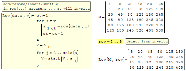

From that huge matrix, you can do almost anything you want before post processing:
1. submatrix for a chunk rectangular/square
2. specify a selection /rows/cols
3. replace part of a matrix by another
4. rotate a gray scale image matrix
5. rotate an RGB image matrix
6. zoom up/down any image matrix

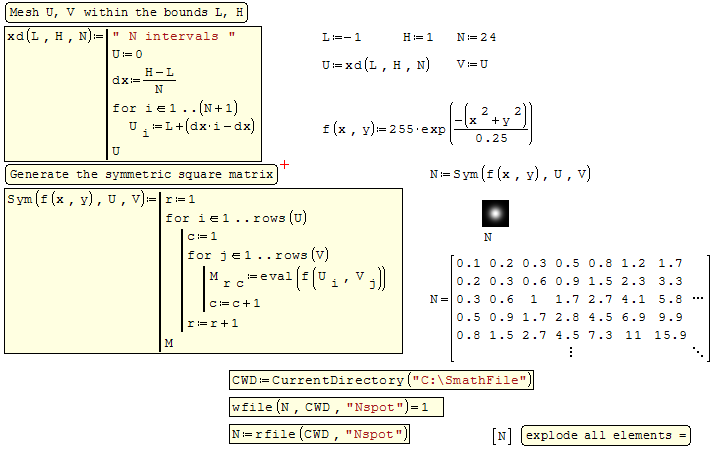

If you attach that huge matrix and explain what you want to do from it
we can probably reply very soon.
NicolasMatrix.sm (81 KiB) downloaded 75 time(s).

how to replace such a mammoth matrix, for example with a SMath table, which assumes that it was provided with the possibility of adjusting the dimensions.
row/cols adjustable matrix, Mathcad style, c/w row/col identifiers
that is not available in Smath as conveniently than Mathcad.
You can examine few rows at time, even by selected chunks of cols.
Easy to add the numeric up/dn push button. I have done that few times.
